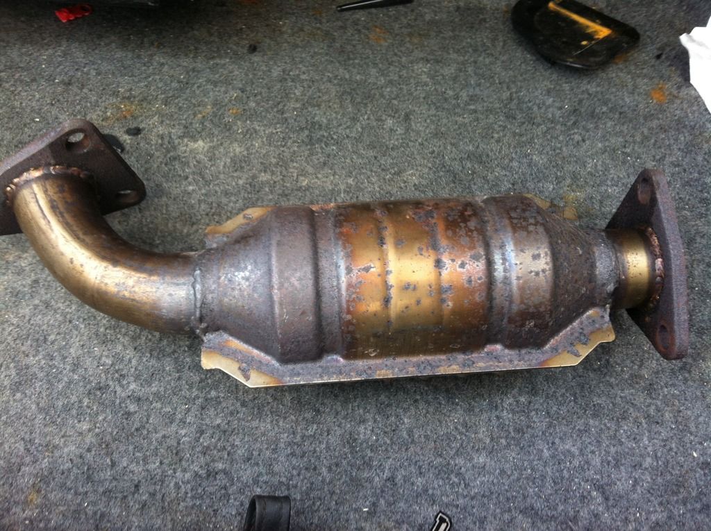

Hi thanks for the quick reply. Did the cam sensor a month ago kept getting cam fault code. Checked live data and lambda is switching OK. Suspected the cat cause when I bought the zed it looked like a cheap botch job. Recently been getting a bad rasp noise and rich smell at the tailpipe. The car runs sweet at pulls very well.

Could it possibly be a temp sensor problem. I don't get any fault codes..

Sorry - need the more experienced guys to answer that one. Can you get a pre - MoT emissions test done cheaply then you'll know what you're dealing with?

Makes sense getting a emissions check done. Just thought everything else is OK and the lambda is working OK. The cat that's on when I bought the car is a real nasty one.

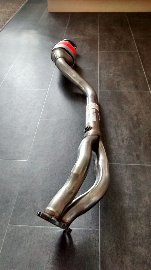

bit the bullet and got a new cat for the zed.
decided to go for a react cat from eurocarparts... £73 and £56 for a bosch lambda sensor while iam at it
just got to fit them... the cat looks well made....

Well done - you will probably need a new gasket for manifold end if you haven't already got one. You may get away with the old one and sealant but it's a gamble. Good Luck.
Billyuk1966
Aug 17, 2014
39
manchester
Cheers. Thought I did well with the prices.
Got a new gasket.. Rubbers...and bolts on order with the local bmw agents. Might as well replace the lot while I am at it.. Hopefully last a while once done.

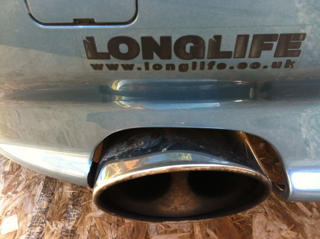

hi all,
just an update. fitted the cat and a new backbox as well. rubbers and gaskets.
i used the backbox bellow
http://www.ebay.co.uk/itm/BMW-Z3-CA...ar-Silencer-/161545926468?hash=item259ce33744
shouldn't have been a cheap skate as the backbox is noisey ( baffle noise)
have any of you chaps used the backbox as in the link and was it ok?
thinking of trying to quiet the exhaust now and was wondering are db killers any good
would they affect performance.

@spurs fan in a coupe has a 1.9 Long Life exhaust at the moment I think. Maybe the back box off that would be an idea?
