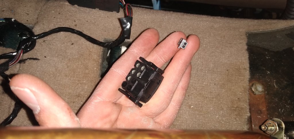

I removed the whole center console and instrument panel, I didn't find anything obviously loose or accidentally unplugged but I found several wiring connectors that do not attach to anything. None of them have obvious homes that I saw. My Z3 does have an aftermarket radio so if someone them were part of the old radio system, that would make sense. Attached are pictures of the connectors without homes

I removed the whole center console and instrument panel, I didn't find anything obviously loose or accidentally unplugged but I found several wiring connectors that do not attach to anything. None of them have obvious homes that I saw. My Z3 does have an aftermarket radio so if someone them were part of the old radio system, that would make sense. Attached are pictures of the connectors without homesView attachment 216897View attachment 216899
The little plug is for a light. I think the other plug is for the hazard warning switch. If it is for the switch, the light will be for the ashtray.

Clutching at straws but there is the alarm light fitted at the rear of the centre console. If this hadn't been plugged back in, could it cause the problem?
