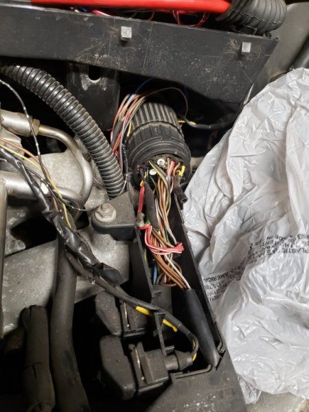

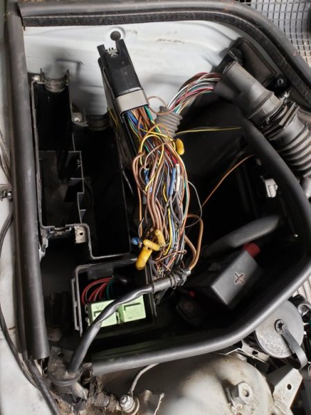

Ok, i was in the process of that when i noticed some wires had been cut and added. Here's a photo from under the air intake. At this point I'm wondering should i just find a new wiring harness?

Yes you can get another wiring harness. Is it just the engine harness or has someone sliced and dices the main car harness too?
Have a look at the EWS wiring under the dash. Has it been sliced and diced as well?
At this point, you need to consider if it's worth all the effort and the continual ongoing costs until you either finally get the car up and running or decide to sell it or part the car out to partly recover incurred costs.

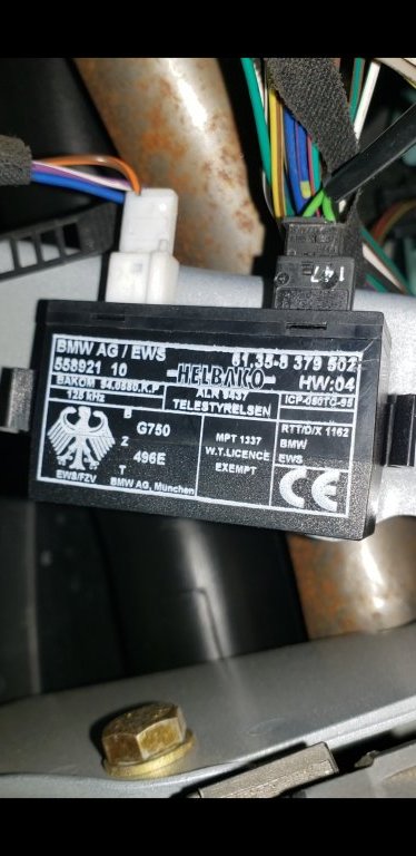

So I pulled the engine wire harness out because there were cut wires. I bought a replacement engine wiring harness, key, ignition, EWSII, DME, and lock set.
I don't see any damage to any of the remaining wires so if i replace these pieces should that solve the security lock problem? There's also this box above the pedals. Do I have to replace it too? I don't think the pieces I ordered come with one

The photo of the black box is your EWS. I'm guessing that the white box with the yellow connector in the photo of the items you purchased is the EWS in that set. They are different.
A couple of options:
  • Find a kit of items that match your car.
  • Work through the EWS wiring for the different models/year builds and patch the later version EWS into your car.
  • Have a look through all the parts that came with the car and see if you happen to have the original DME that matches your EWS. This assumes that the EWS installed is the original. You can check by scanning it to see if the VIN number matches your car.
You are going to need a scanner with BMW software and to be able to code new modules to your car. This is an interesting case as your Z3 is a 97, so the DME is OBD2 but the rest of the car is OBD1/ADS. Read this thread. https://zroadster.org/threads/how-to-scan-early-model-z3s-pre-build-date-03-98.39937/

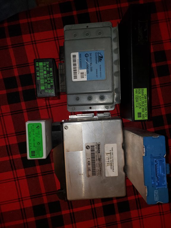

Here are all of the electronic boxes in the car minus the BMW AG EWS which is the picture of the black box under the steering wheel. The document you just shared says it is the transmitter/receiver module. I think i sorted through and put the original set back together. These all came from under the glove box except the DME. You can see on the DME it says "This unit is unrepairable and is being returned as is".

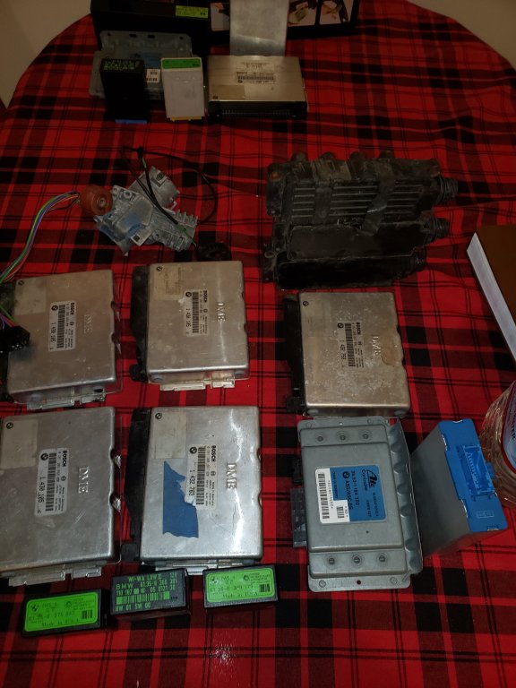

And here is a photo of all the other electronic boxes that came with the car.

Seems to me with all those modules you need to check what part numbers were fitted to your car when it was built so you know the part numbers it should be fitted with. No good just fitting any module to the car they have to be the right one for the car. Recent job I sorted on a Z3 for a member with an airbag issue turned out that the wrong part number module had been fitted before he got the car and following a self inflicted fault when he turned the ignition on with a seat disconnected gave him an airbag light that couldn't be cleared. He had tried fitting a used module from ebay with the same part number but that proved to be locked up with crash data that couldn't be cleared. Research using Realoem parts site revealed that it was indeed the wrong part number for his car. Managed to source a correct module from one of our resident breakers and that was installed on the car followed by coding it to the car with NCS Expert which turned off the air bag light and restored the module to full working condition. Worth noting Realoem will list modules that are suitable to be fitted retrospectively or not if the part number list displays more than one module in the listing for your car.
Go to Realoem enter the last 7 letters and digits of your Vin number and take a look at each of your modules part numbers and compare the pile of modules you have.
The one you have with the label saying unrepairable would appear to have been sent off for repair and found to be totally duff and unrepairable so thats going to be a paperweight.
