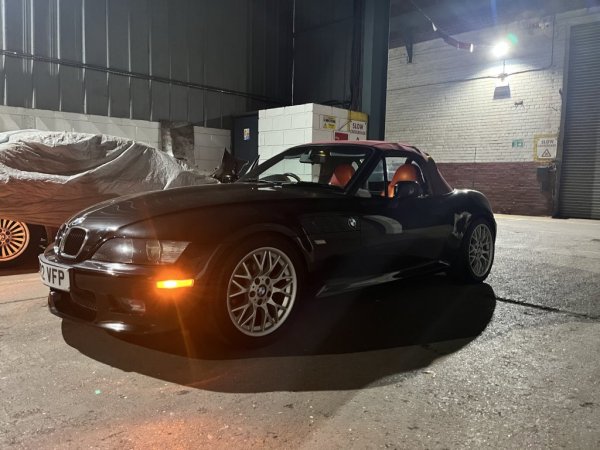

Wheels were replaced this evening.
I went for a set of BBS RS replicas in 18" Dare DR RS.
I half feared 18" would look too big, but I think with the lower profile tyres and the lowering - it just about pulls it off.
Went for Kumho PS72 tyres - I believe they have only recently been released and have good reviews so far.
Will get some better photos over the weekend.
