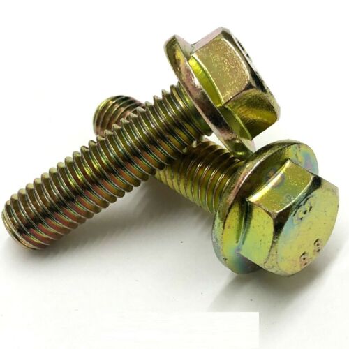

Not sure if it's myth or not... but I was practicing some zinc plating and I read somewhere that anything high tensile should not be plated due to "hydrogen embrittlement".... has anyone experienced zinc plated bolts shearing ?I used some zinc flanged bolts off eBay. I’m can’t recall if I used 10.9 or 8.8 though.
I’ve bought quite a lot of hardware from eBay in either zinc or A4 stainless (=8.8 strength) mainly as it worked out cheaper then buying from the dealer. Sourced from Bolt World, kays,a2zfast65, boltbase and
8.8
FLANGED HEXAGON BOLTS HIGH TENSILE 8.8 PLATED STEEL FLANGE HEX SCREWS M6 M8 | eBay
Find many great new & used options and get the best deals for FLANGED HEXAGON BOLTS HIGH TENSILE 8.8 PLATED STEEL FLANGE HEX SCREWS M6 M8 at the best online prices at eBay! Free delivery for many products.www.ebay.co.uk
10.9 (apologies from china couldn’t see a uk seller in zinc in std pitch)
Just check the thread on your bolts as I can’t recall if the pitch is standard or fine.
