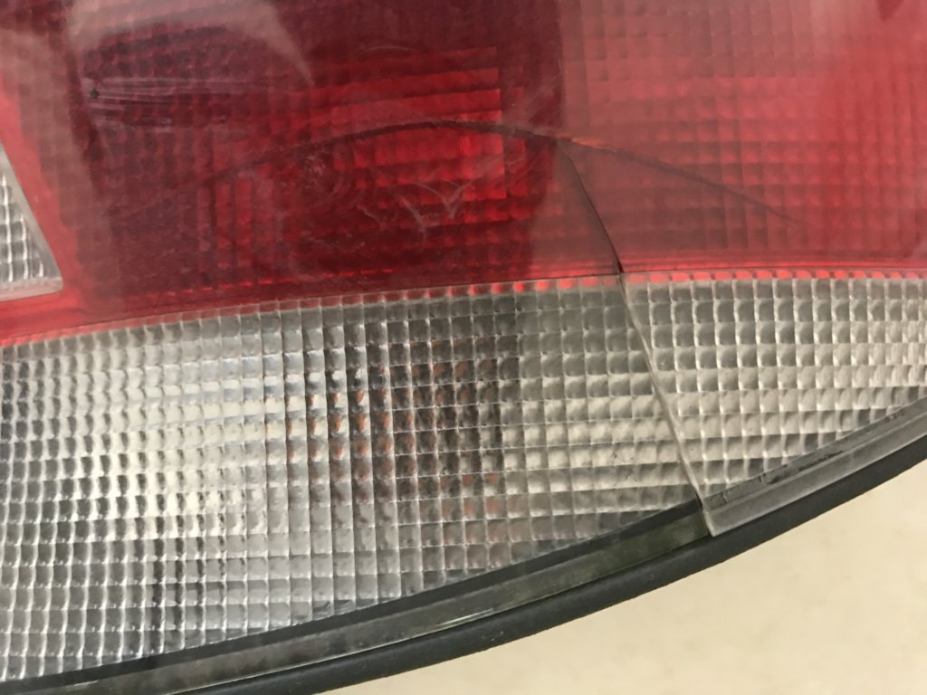

My NSR light unit was cracked and although still working, it was offending me. Sooner or later water would no doubt ingress.

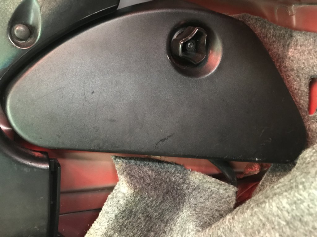

First task once inside the boot, is to remove the cover which is held by a similar knob to the pre-facelift cars.

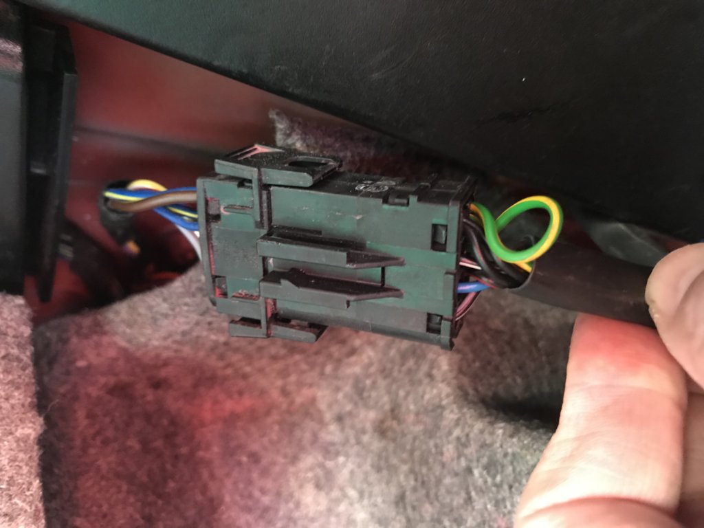

Tucked under the carpet is the connector which you have to pull apart having squeezed the tags on each side.
After disconnecting the light unit, there are then 3 flanged nuts to remove with an 8mm socket.
The big one at the top with the long length of thread is the one that the cover knob engages on. Take care not to drop the flanged nuts as they are quite fiddly!
