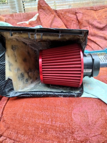

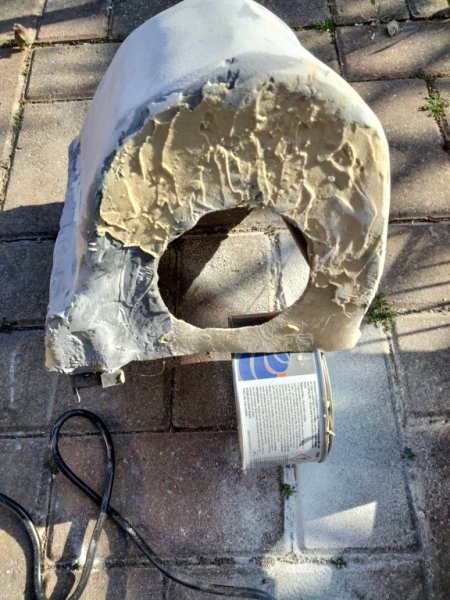

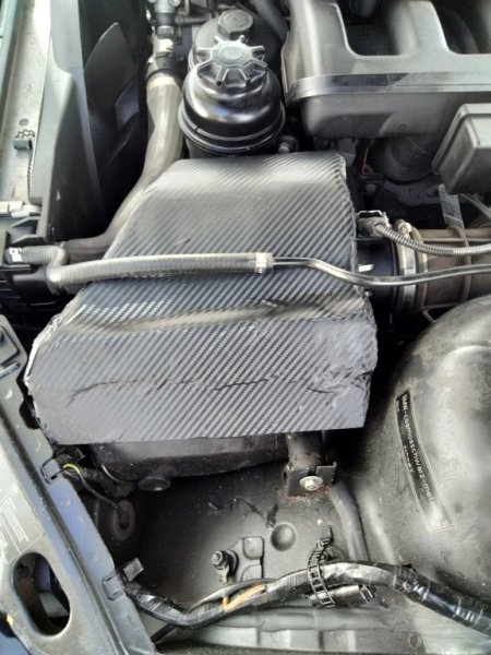

made my own filter housing so i could use large high flow cone filter in instead of the flat bm one. its only reinforced fibre glass with a bit of vinyl i took old one out cut it in half around the mould joint of the bm housing kept lower half as this fits into bm own cold air feed. its a very tight awkward fit. not a very proffesional job if i could i would get a proper one made but omg it works it stays cool all the time well happy it will do for now see what gains i get when retune is done see pics. may have to move power steering oil filler about 5mm so it goes in easier thanks Taz
