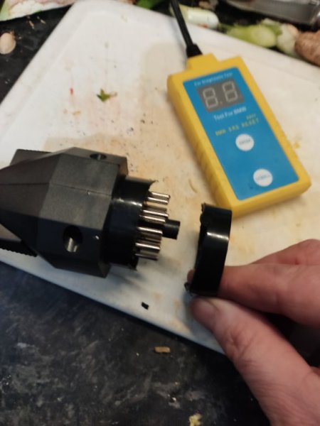

Hi is that a picture of the cable I would plug into the reader? Then pop it back into the port? Thanks
Zephyr
Aug 10, 2022
136
This is your external obd reader cap located under the bonnet.
you will bridge these two pins and put it back in place over the socket.
then you will use the internal obd located under the dash to read your codes.
I understand that your scanner has two sets of wires, one ending in a round end to fully read the codes externally (bonnet) and one square to read the codes internally.
the internal obd provides basic functions and you can not read all the vehicles modules, but with this “hack” it acts as if it is the external.
so if your “round” cable does not “talk” to the car, you can use the square ended one and check if the cable is the problem and the scanner does not connect.
if both ways do not work, then it is either a scanner issue or a module issue in the car.
I hope what I said makes sense.
