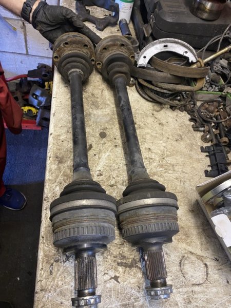

We next inspected the drive shafts. The drivers side had been replaced but with an older shaft that had clearly had a tough life. God knows how the rubbers twist.
both ends had holes in, were surprised it didn’t spray grease everwhere.
we’ll need to order a gator rebuild kit, we keep non M gators in stock so you can at least see what they look like.

Also some photos, copied over from the drive shaft thread. I used the BMW drive shaft repair kit, god knows how this shaft got in such a bad way. Was a very simple job just very messy.
Twisted boot.
All removed and new boots fitted with new clips.
Diff end.
Whole shaft. As much as it would be nice to redo both shafts these kits are very pricey so I would recommend doing them only if you really need too.
