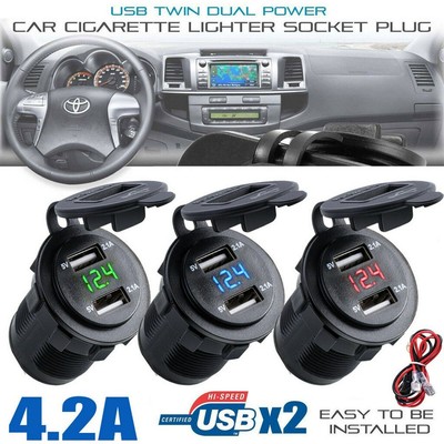

colb
Nov 25, 2012
178
Newport, South Wales,UK
Always thought the Z3 and Z4 should have had battery condition instrument included in the instrument pods so it can be monitored. After an alternator fault developed on my Z3 I replaced it and added a voltmeter with usb sockets to one of the vacant switch blanks on the dash, that provided the battery state monitoring with the added bonus of a couple of usb sockets for phone or Satnav to be plugged in. Wired to the exhisting cig lighter socket was quite easy to access without stripping any of the trim out, managed it working in the footwell. Having done that to the Z3 I wanted the same on the Z4 but used a round version of the voltmeter as opposed to the rectangular one used on the Z3. Fitting this did involve drilling the plastic part of the dash trim but achieved that without any problem, wired to the cig lighter in the ashtray, simple to accesds the wiring by lifting out the ashtray and fising the wires from the usb voltmeter to that location to make the connections. If anyone fits one just ensure you position it so the steering wheel dosn't mask it from view when your driving so you can't see it, mine is a little masked but easy enough to see depending on the position of the steering wheel.
