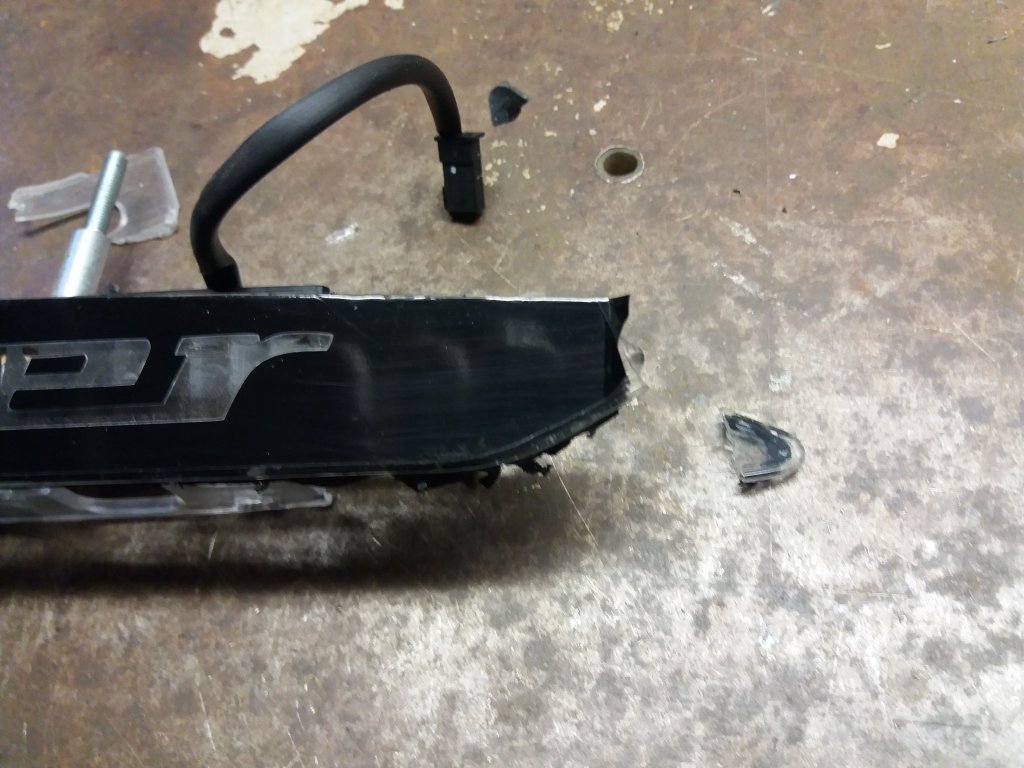

Usually it's one end or the other which gets snapped off as they do sit a little proud of the bodywork.

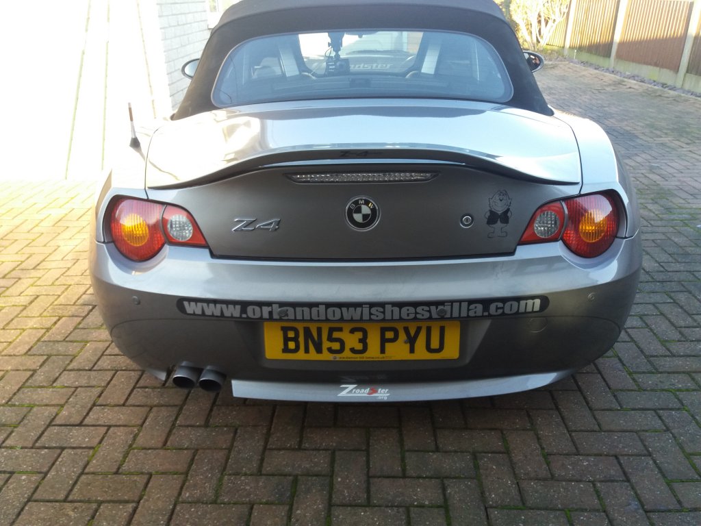

To remove the light unit , raise the boot lid and look for three round holes in a line across the lid.

Once you have removed the 3 nuts and disconnected the wiring you can remove the old light, this usually means it coming out in bits.
