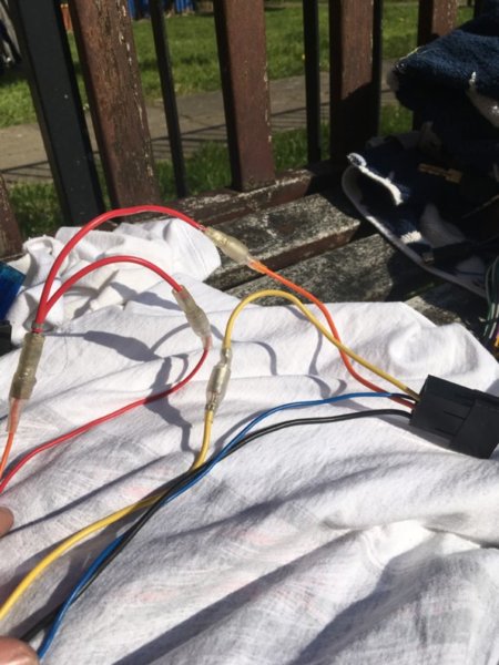

Managed to find a new headunit for the z locally and for the small fee i now have a new headunit with Bluetooth, wireless and Auxiliary cable input in the car. Only CD and radio before. However, i'm struggling to get the device to even turn on. Thick black cable went in no problems and two plug and play style ports was all that was installed for the last Alpine headunit and have plugged in the same ones to in again.
One thing i did notice is that the stock bmw female is a circular whilst the new adapter that comes with the car is a rectangular style input. The Headunit plugs in to everything. However, i don't think that with each prong being plugged in, i don't think all the corresponding wires are in the right place to get connection.
Model i have bought is Alpine cde 103BT
Any ideas would be great. Would be nice to play my own music in the car.
Halfords sell numerous wiring adapter cable for car audio. Makes these type of issues go away for about £15.

In turns out I might already have the correct harness just not with the red 12v plugg in the system. Not sure if what I’ve done is a good idea but I have spliced it into the 12v and oranges illumination into one wire that attached to the harness adapter. Will I short the circuit?
Any help appreciated.

You still trying to sort the stereo
I am indeed. Have realised that fuse 9, a little 20a has popped and the spare in the fusebox has been replaced before. I think i'll need another connector to properly do the job too. I couldn't unmount the wire from an unused male connector as i can't quite pry open the chamber to release the wire. It's probably my dodgy impatient connection that's shorted it somewhere and tripped the system.

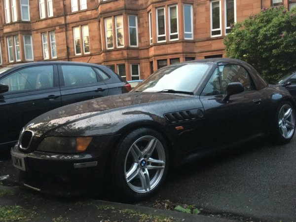

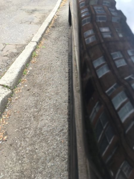

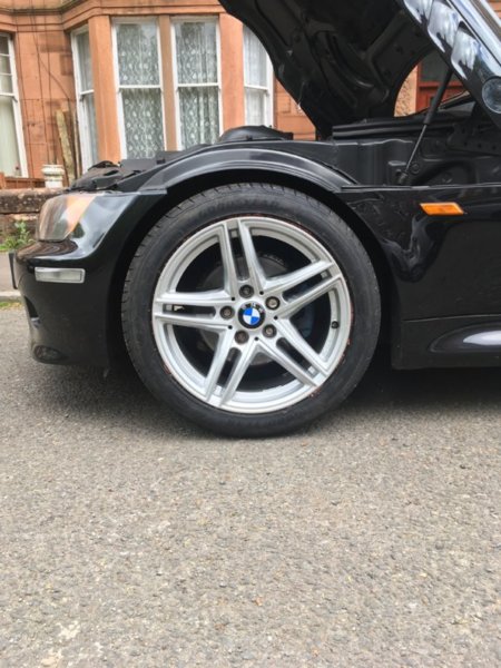

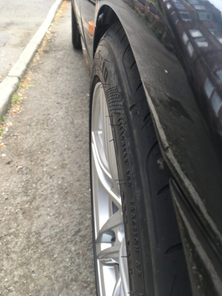

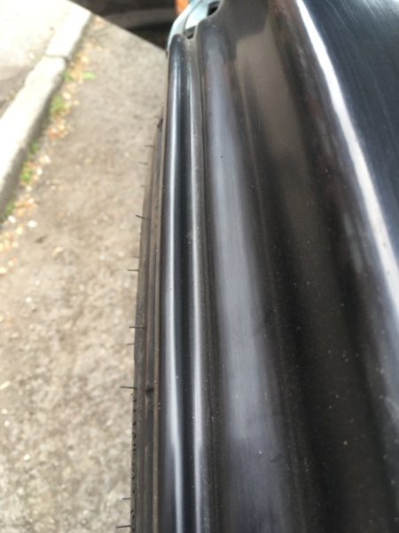

New Shoes and soles all round. Forgot to take a picture of it properly and it's now surrounded by neighbours automobiles. Took pictures of fitment. The gods of negative camber were not kind. I didn't get anywhere near as much negative camber on the front is id hoped. I had fitted the et30's on the front of the old m44 and seemed to get away with it more than i am at the moment. It's v close. Hoping not to shred the outside of my tyres on the plastic arch trim. Need to run them a few miles but i have to say ride quality is instantly better. The garage that i got them fitted has an entrance like the himalayas and after the 17's were noticeably smooth. Don't seem to have any rubbing on lock which there was a bit of.
Need to be careful on speed bumps and potholes as usual. A few fitment pictures. Perhaps this might be of use to someone else. 17x8 ET30 225/45/17 all round. Car was lowered by previous owners so id guess at 40mm. Pretty low.
