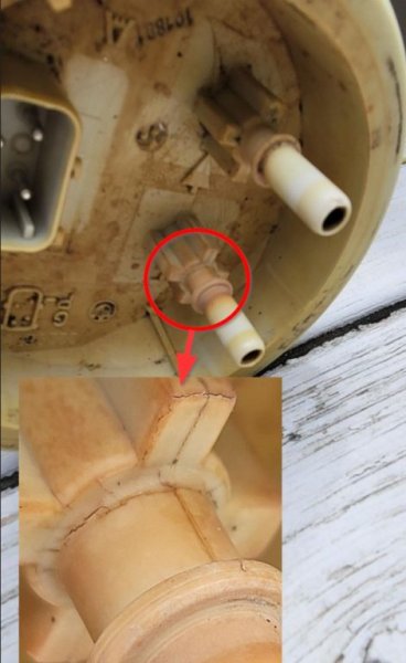

After weeks of trying to find gas smell I finally found the root cause. The actual plastic assembly was cracked. (See photo)
Did anyone else ever come across this issue?
Also, the only one I could find to replace this was one that had the line attachments at a 45 deg angle and not 90 deg as shown.
I plan on mounting the lines with fuel hose and clamps.
Any other suggestions are greatly appreciated.

I thought all the Z3s had a similar fuel pump mount? My 98 has both the supply and return angled about 45 degrees. Only way the pipework would fit.
