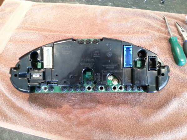

The original one from my car, black housing for the control units. The three larger green bulb holders contain the main gauge illumination bulbs so I fitted new ones of these as a matter of course. They are 3W rated 501 type bulbs.

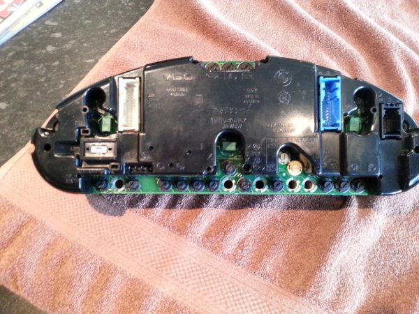

This is the one I got from Andy @spurs fan in a coupe for a very fair price, and although the different coloured housing meant it would not be a simple swap over, it was the housing and front (glass) that I needed. Once you have removed the 5 screws the black or green housing will lift off leaving the front part of the gauges still attached to the main housing (the bit I needed - so you have to split these).

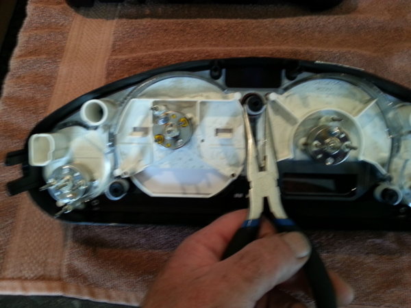

In the previous picture you can see 3 black plastic posts which have a white plastic collar around them, the are what fastens the gauges into the main housing, to release the gauges you need to take your long nosed pliers and turn the white plastic collars through 180 degrees, then you can lift the gauges out of the main housing. Leaving the three component parts. This where you would have to get to if you wanted to fit some white dial faces available on line @Mint. Also, like me you may find that you will have to swap the coloured plastic strip with all the warning light icons along the bottom of the instruments. This is easy to remove by gently levering it off the (6, I think) little plastic locating pegs.

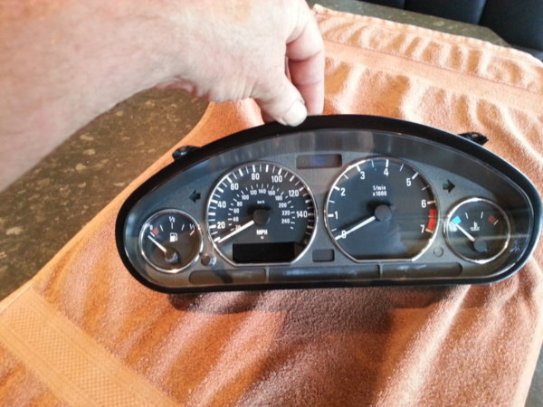

When you refit the gauges into the housing make sure that the Temp gauge is set below zero as when you turn on the ignition it will shoot up and read about 1/2 way to normal before even starting the engine. I found this out the hard way!
Now you can reconnect the wiring and place in the dash aperture, but don't yet push it all the way home. Here you can see that with the ignition on the Temp gauge is at the lower limit.
After road testing, you can see I did 8.3 miles to makes sure all the gauges work OK and all the warning lights functioned as they should. When you're happy you can then push the cluster all the way home and refit the 2 T20 screws. Job done.. Hope this is of some help. Any question please feel free to ask.
