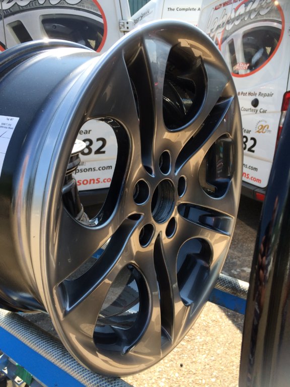

Yeah I am with you there @Stevo7682 they had my Z3 wheels a few years ago and they looked amazing. These will hopefully replace my 108's on my Z4 and it's not a completely standard finish. They are at Lepsons in Gillingham Kent. As it's a new set I can still drive the car and it's been top down all week here, I can wait.

Well wow top job from Lepsons - I am sure not to everyone's taste but I think they look spot on. standard Z4 wheel BMS BBS staggered 107's in black chrome (two tone) at collection and in the box. One the car will be next week

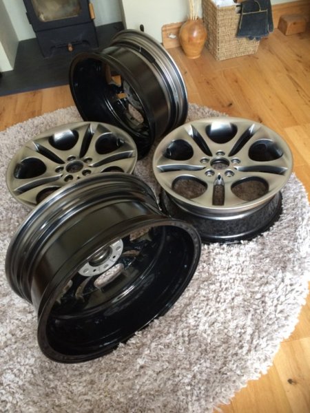

Very nice. It's an awesome wheel but needs a custom finish like this to lift it. hard to Photograph as it changes. Looking forward to seeing it in.
Like the two tone effect Si, will look great on the car.

Hey @Dino D first and only time my wheels will be allowed in the lounge according to Debs. So a picture - although she did suggest a piece of glass on one as a coffee table. But my Zed would be limping then.
I was a little worried being dark inside as I am not a black wheel fan, but I think it works

They look really good. I am getting our 3SDMs done in shadow chrome when I get back off holiday
