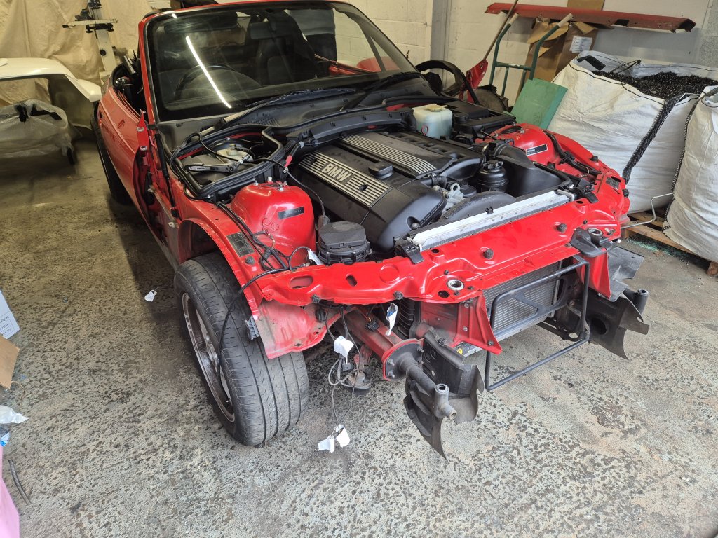

I started my build a few months back and have put some progress to date here. My donor is a 2.8ltr 1998 Z3. Managed to find one in good condition, just over 110k on the clock but in drt storage with good sills and no rust anywhere.
Got the car stripped down in just over a weekend. Tools make the job and save time. Make sure you have all the necessary Torx screwdriver sizes, plus a good magnet to collect those screws that drop in the panels!!

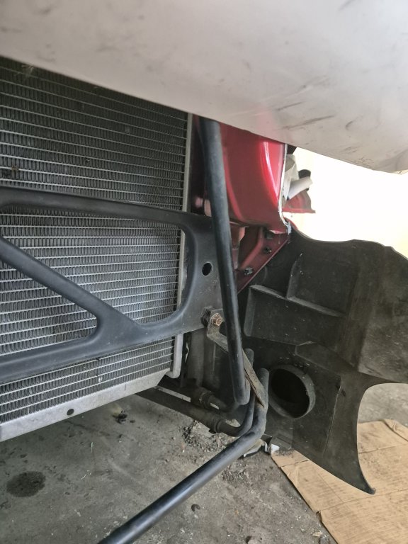

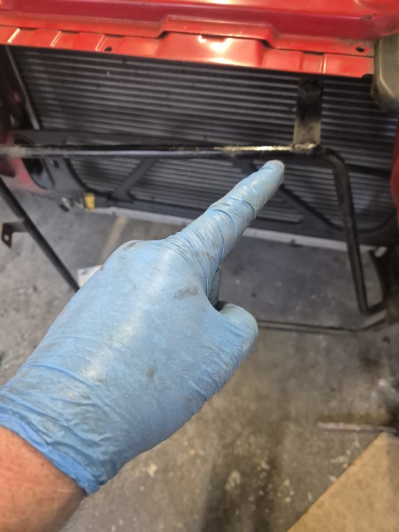

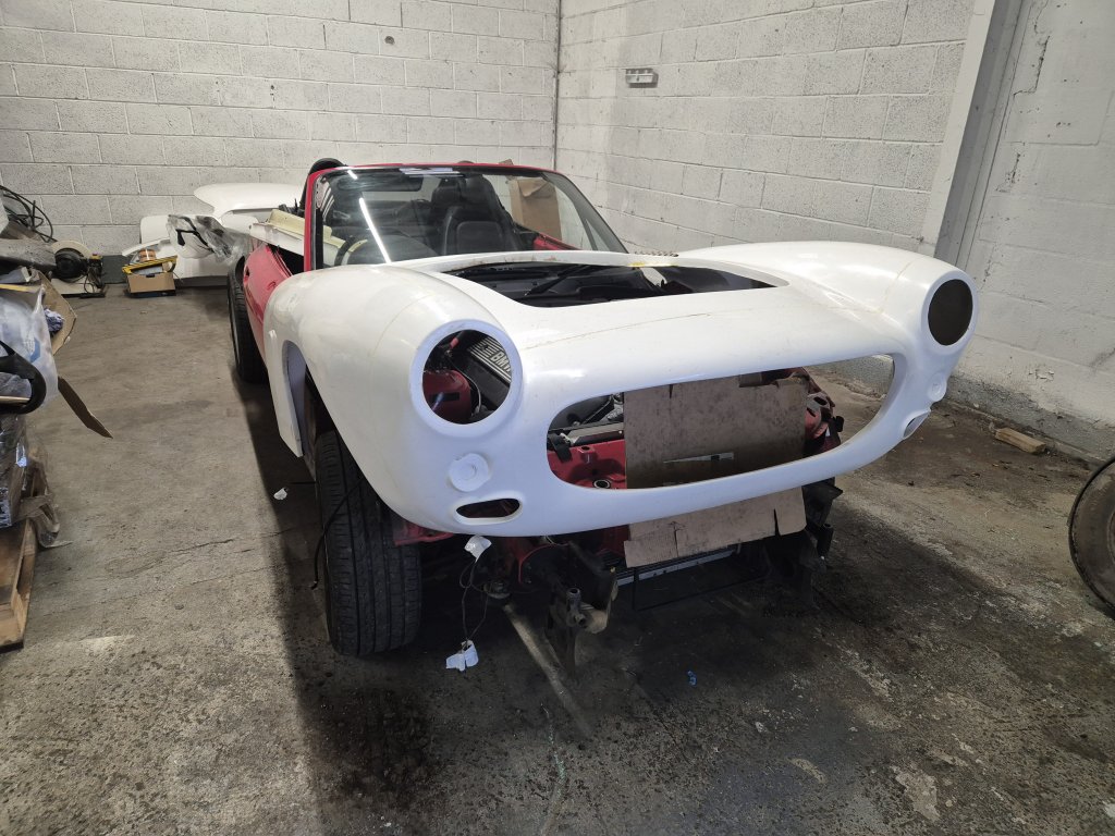

Have the bonnet section mostly positioned right. Just needed to correct a few things and move the power steering coolant loop back to get the bonnet to drop properly.
Bonnet now closes. I need to come back to this in due course to tidy up

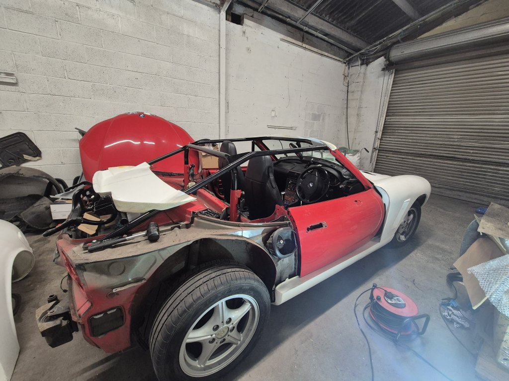

Roll cage fitted and bolted onto the rear at at the front. Dropped in nicely. I had the rollcage powder coated so it looks good.

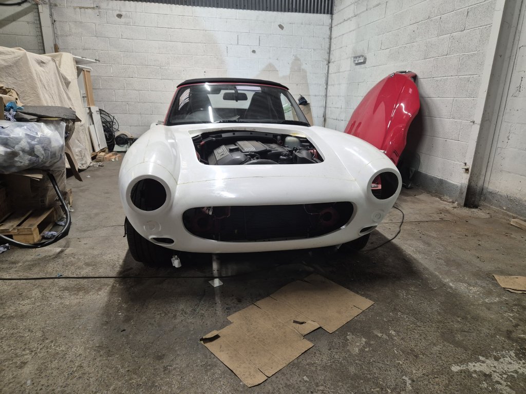

Rest of the body then put on for a test dry fit to see what it's like. Looks relatively good

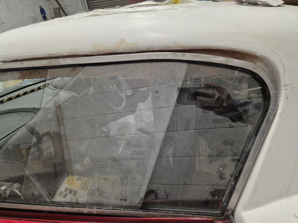

Lots of things to be sorting but the widow gaps to the body are a huge issue to sort out
Will be working on this over the coming weeks but the window frames are off to the chromers to have them stripped and chromed. I've take the original frames apart and sent them off without the glass. Need to wait until they come back to finish the gaps but as it's a 6 week lead in they needed to go off asap.

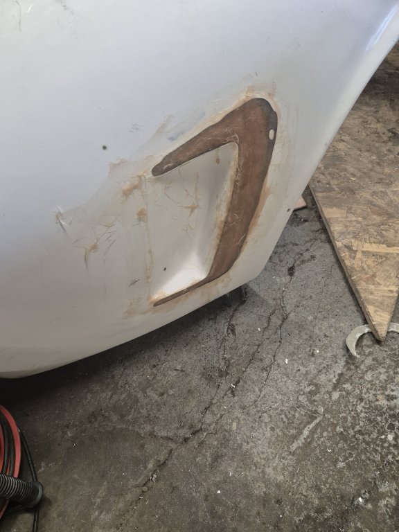

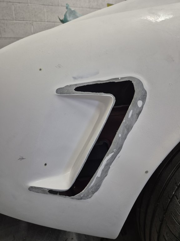

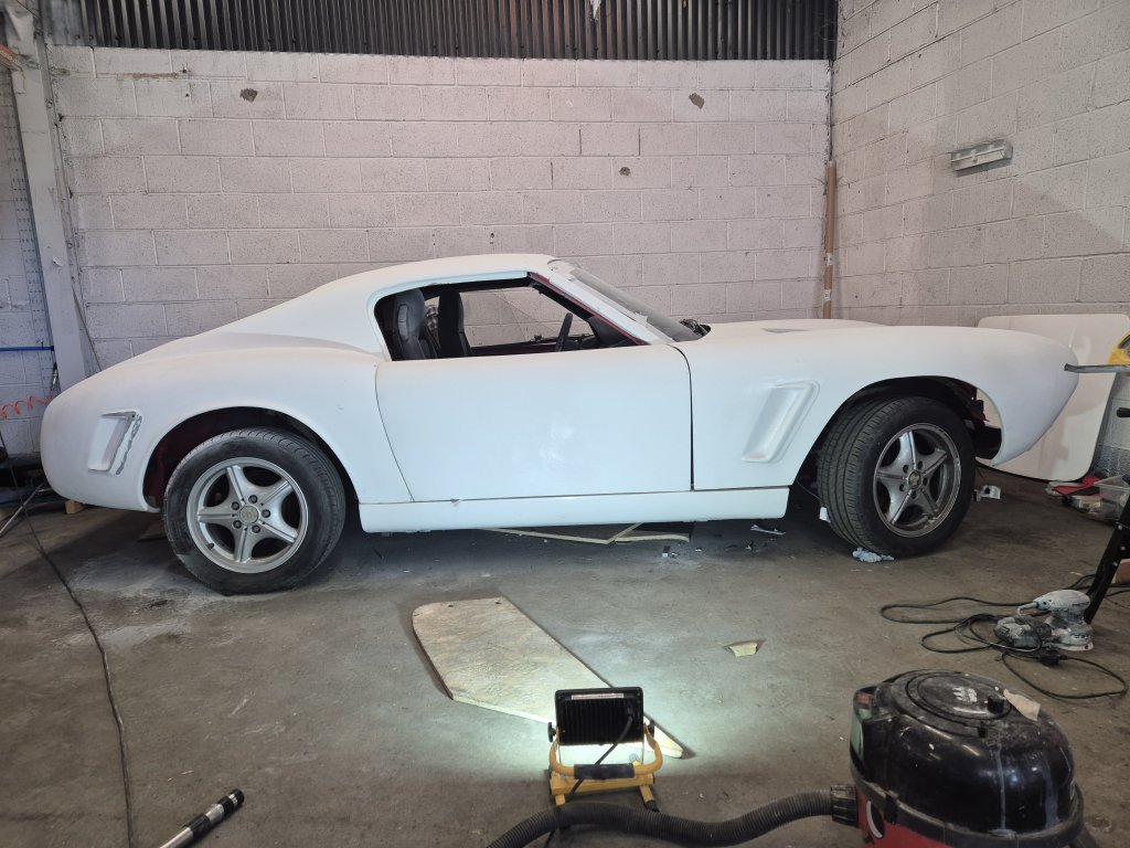

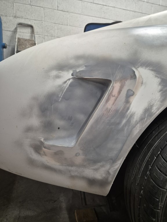

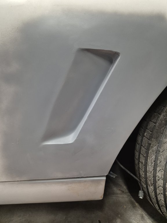

Decided I didn't like thr original brake vents so I cut them out and filled the gap with fibreglass patching. Have them where I want for now. Will be finished later. Will be making some bespoke brake vent covers from 3D printer for making a mold and then will create new ones from those. I fee will look better.
Nice cleaner lines I feel. Now need to model up the covers and get them 3d printed.

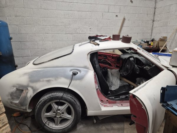

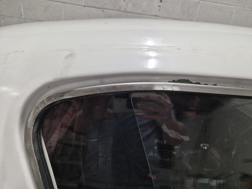

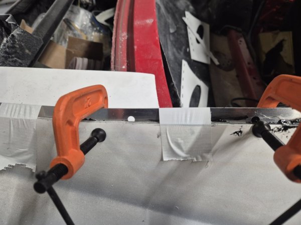

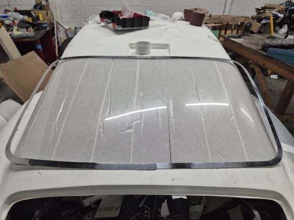

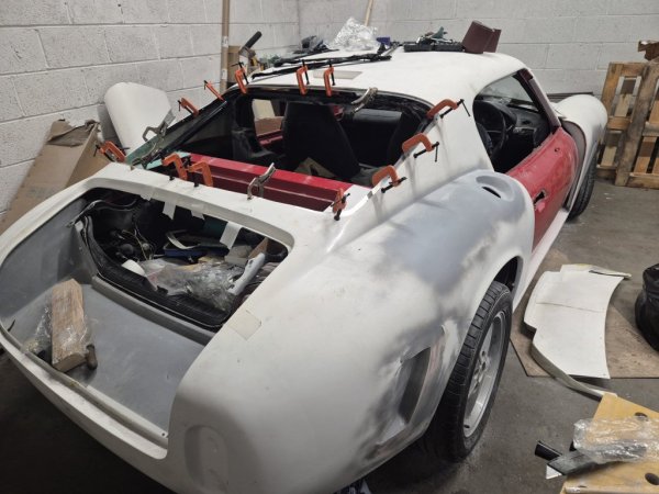

Started to install the Grassbank rear window this week. Have cut out the hole using the guide in the original body mold lines. After cleaning up I've bonded in the metal channels to the inside. Lots of cheap clamps from Amazon. The trim holes are slightly hidden under the body as advised.

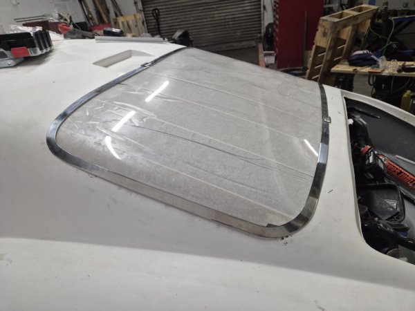

On
trying the trim afterwards the holes could be further under the bodywork.
The acrylic screen is in place but needs a little trimming. Will continue this week and fix.
mittaw
Apr 1, 2024
29
Got the trim sorted today. Not a job for the faint hearted first time around. Takes quite a bit of work to get the screen trimmed to match the cut out, and with the trim detail too. Have got it 90% there. There's still some trimming and shaping to get it sitting on the body flush and correctly. Some small areas where I might need to touch the body up with some filler to get the lines right, but these are minimal. Will try and get if all sitting flush the weekend and get the centre trim sections in place correctly.
Lessons learnt
* get the holes in the trim closer to the body all the way around, some were sat off too much
*Patience...measure, trim, measure, trim, try, measure, trim....repeat
*Start fitting the trim and trimming the screen from the centre outwards and top to bottom before doing the edges, but definitely fit the trim from the side to the middle once all trimmed
*holes in the screen to fit the trim screws through...don't be shy in making the holes as the screen will flex in fitting it
*Fit everything with the body on the car as you need some pressure on it at times, but do the bending and screw fixings with it off if you can as the roll cage is difficult to work around.
*Don't worry about making cuts, measure twice and cut once, but just do it
The kit is really nice but everything needs 'Working' to the body lines and shape of the back. But once done the curved window looks great.
Will need to look at the rear parcel shelf too this weekend so it fits with the window opening.

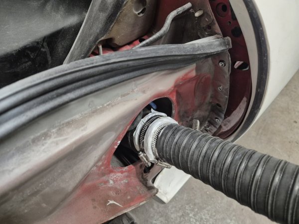

Body on and sitting now to set. Long day getting all trimmed. Fuel filler to the wing was a nightmare I don't want to do again in a hurry. Did if before setting the body but working alone it was very difficult without being able to get the body off with an extra set of hands.

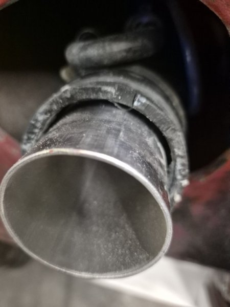

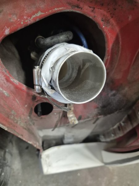

Used a short length of aluminium pipe to insert into the existing filler pipe. Removal of the existing filler section is a fiddly job but a bit of force helped it out. The aluminium tube slides into the existing filler and stops as the existing filler pipe narrows so it has a natural stopping point. I thought about using a larger 90 degree section of fuel pipe that sits over the existing fuel filler pipe but I wanted a more direct fuel travel into the tank and didn't want fuel sat around any join with the bigger pipe. I've seen it done both ways.
I made a gasket out of fuel resistant gasket material to push around the edge then sealed it around the gaps. The gasket will stop any sealant running down the outside but didn't over due it with sealant in any case.
Another home made gasket over the top of the sealant and taped for good measure while everything set. Was tider tha. The image shows in the end. Fitted some flexi fuel filler hose to the aluminium pipe with a little more sealant and then connected that to the fuel cap on the wing. I have to bend back some of the body metalwork so there was no part of it touching the fuel hose.
I attached some old boot rubber to the body just to give some extra protection from metal work. I also put a length of larger thick fuel hose around the flexible section. Ive gone over the top but I just want to be secure.
