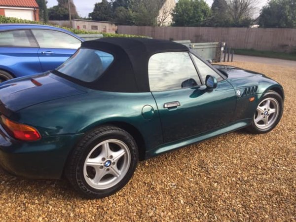

Hi , new to this & the forum...my Z3 seems a little "twitchy" over bumps in the road, had the wheels balanced, breaks done & bushes checked, is this the "norm" for Z3's or do i need to replace rear tryes...any suggestions would be very helpful. Thank you in advance.
