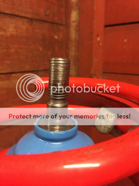

One thing to take note of for M Roadster owners is that the front shock top mounts are "handed" so need to be fitted to the correct side of the car. It states which side is which on the unit itself.
Fully assembled shock & spring below.
Ta-da!
No real surprise to find they are original factory shocks. I don't think Niall has anything in his service history to show they've been done previously, so 107k on this set.
Rear springs and shocks are a little more straight forwards. Niall happily sorted undoing and redoing the top mounts on the shocks. He seemed to enjoy being cramped in the hood storage area!
This a close up f the rear shock top mounts, and you can see where the rubber is delaminating from the metal core. About as bad as we've seen before...
