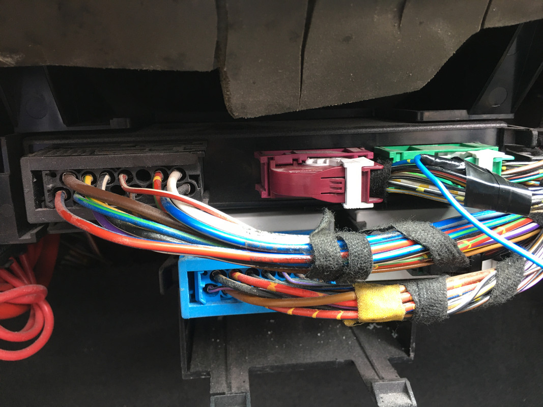

Easy deadlocking cure
Attach a wire to the blue/yellow/red wire from the ZKE A104 module behind the glovebox. The ZKE module has 3 plus, you want the centre purple one.
Run this new wire to the boot, lock the car using the fob, touch the new wire to the positive battery terminal and the doors will unlock
Now I would love to claim this stroke of genius as my own work but someone is bound to grass me up so all credit to gookah on the Z3 forum.
But will it work if the solenoid is dead?
jaguartvr
Jan 9, 2017
95
No idea, I have never had a dead solenoid but I have had Z3's deadlock on me several times.
If you are building a kit this is the first modification that you should make.
If the solenoid was dead I would have thought that you would be able to open the door using the inner door handle, if it has deadlocked the inner door handle won't work.
If only!
the solenoid on mine failed on the locked position so pulling the internal handle lifted the button slightly but even manual lifting of the button would not release the lock. I had no external key option either.
As soon as the solenoid was separated from the lock it worked again.
Even with battery disconnected you could not manually open the door.
