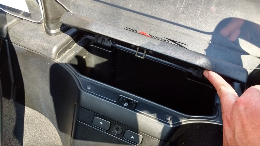

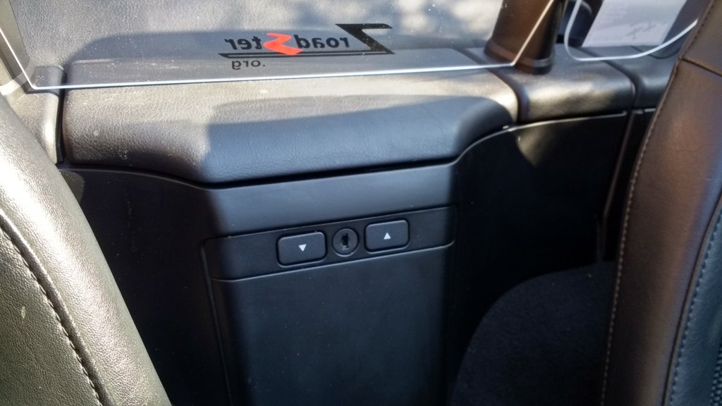

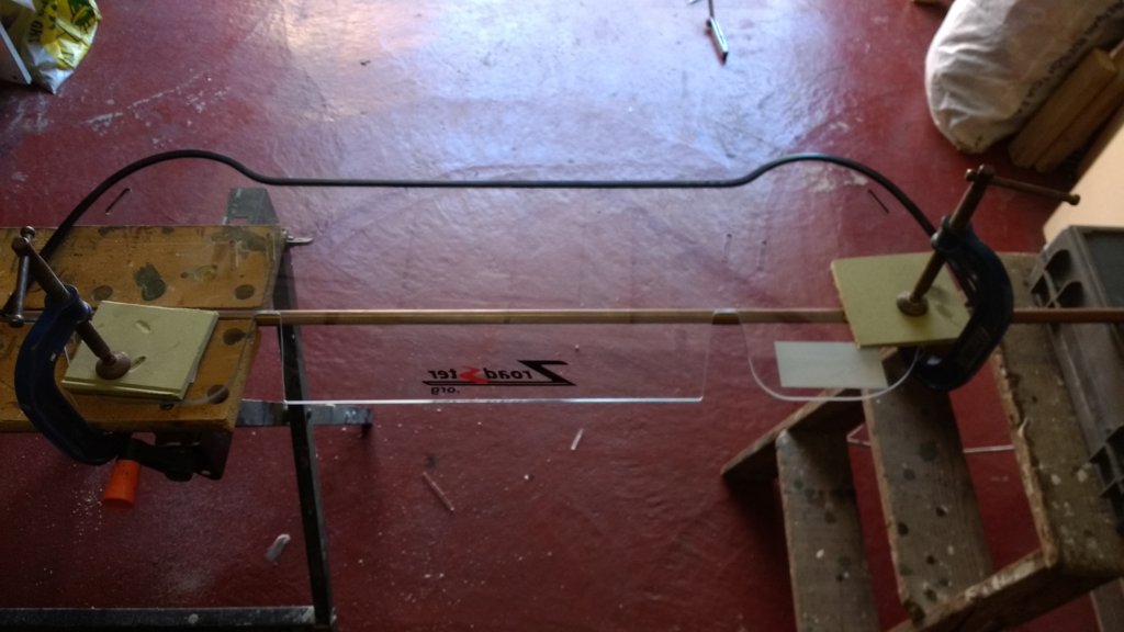

As many of you are aware, if you have a standard Perspex wind deflector, access to the Z3 cubby box is impossible without removing it first.
So I came up with this easy fix so that you can gain access to store your trinkets.

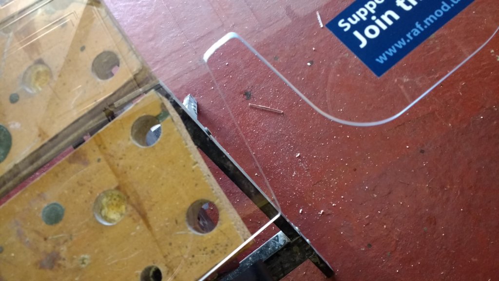

1. Enlarge the bottom inner cutouts by around 4mm. I used a fret saw and then cleaned it up with a file.

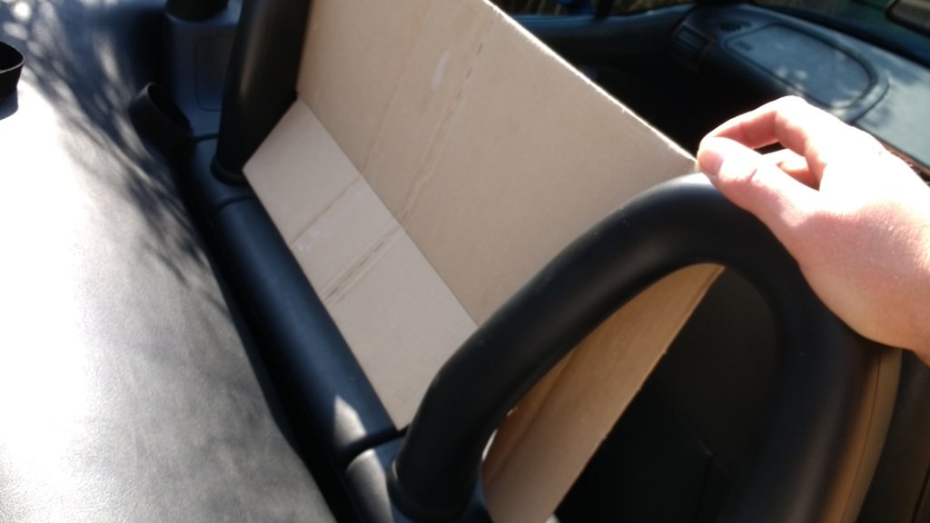

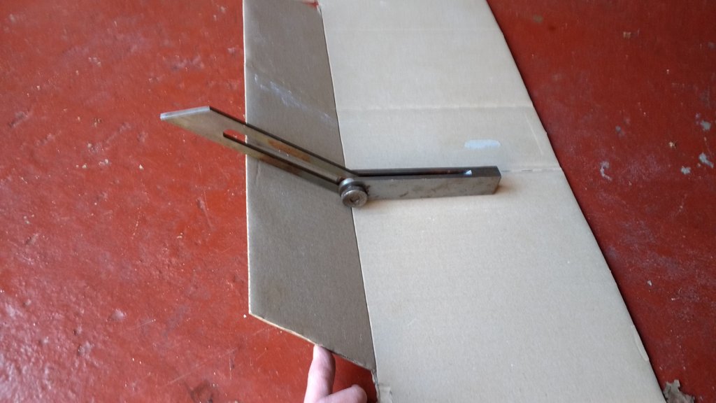

2. Make a cardboard template so that you can work out the angle required for access.
I then used an engineers bevel for later transfer of the angle to the Perspex.

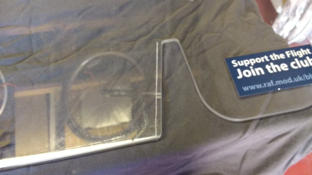

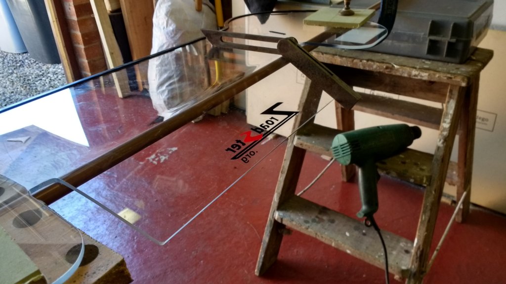

3. I then rigged up a length of 15mm copper tube and clamped the deflector to it with the top of the cutouts in the centre of the pipe.
4. Then apply heat evenly along the bend line for around 5 minutes until it becomes pliable and then bend to desired angle. I used a heat gun.

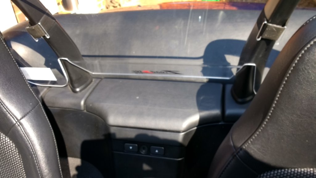

5. Fit back on car and admire your handy work.

I had mine on the outside when i 1st got it and yes allows access to storage box but look wise way better on inside but no storage access :(. so really liked what you have done @Eddie Zedder .
I am interested in trying to do this how easy did the perspex bend how much heat required and did heating it mark it .

Hi Steve,
I used the type of gun that is used for paint stripping on the hot setting.
The key is to keep it moving, about 4-5" from the surface. Hover in one place too long and it will cause bubbles on the surface!
It took about 5 mins of heat, try to bend it every now and then, you will feel when it is pliable enough to complete the full bend.
One thing I wouldn't do if I did it again is clamp it at both ends, as it will rise up in the middle, but once bent and held down in the middle while it cooled it was fine.

Not tested it for effectiveness yet, but I think the ideal solution to close up the gap would be to start with a fresh piece of acrylic that is longer at the bottom centre section. You could also have a return bend on the bottom edge to curve over the back of the cubby box.
If you make one like this @Shortie_gal, @Lee, i will gladly test it for free! :whistle:

I've made mine like this for this very reason, leaves enough room to open the box and makes no difference to its effectiveness.
