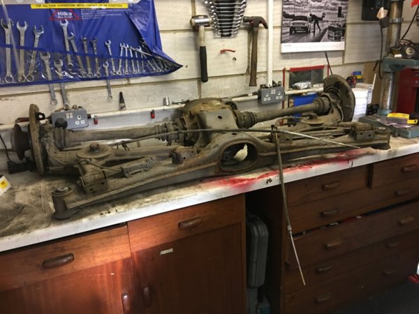

Up on the bench ready for tear down. There is the usual covering of muck and surface rust, but nothing excessively nasty lurking.
No surprise that the rear beam bushes are seriously deteriorated. Lots of movement and the rubber is starting to de-laminate from the metal core. New bushes have almost no movement in them.
