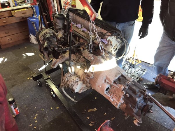

ZedShed on a FridayI hear you say! Yes! The project continues with removal of the M52B28TU engine removal...
The intake manifold has to be removed to expose the rear engine lift point, so here is the engine with it removed.
Annoyingly there was a fair bit of crud on top of the manifold which fell down in to the top of the cylinders. Quick blast with the air line sorted that out for now, the engine is getting a thorough clean and partial strip down so will be double checking they are clear.
The manifold once removed.
Engine hoist connected to the front lift anchor.
Engine host attached to both lift points. In retrospect we should have pushed the main beam out further, but it worked a treat.
Back of the gearbox
Gearbox off. Looks like it was taken off once before as whoever did the work cross threaded two of the bolts, which snapped off (no choice on that, but will be easy enough to drill out and re-tap the threads.
Clutch plate getting low, don't forget the Sienna donor had a towbar on it and it was used quite often for towing.
Pic of the flywheel. May get a lightened replacement...
That's it for now, next stage is a partial tear down of the engine and general clean up. Definitely needs a new rocker cover. More updates as that progresses. Spent the rest of the day stripping the interior and other parts out of the donor ready for sale!
