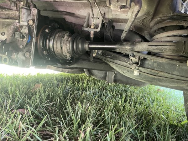

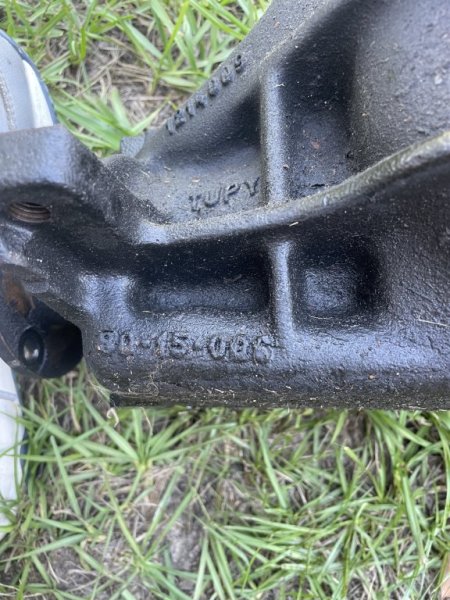

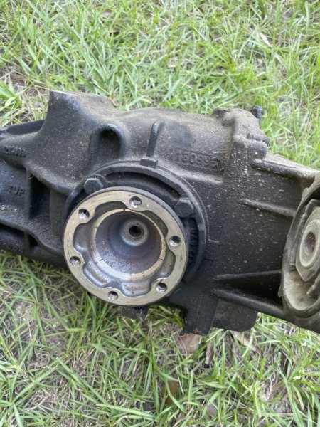

Tried to replace my rear diff and it all fits but the wheel axles connections are bigger than on the older diff? Can I get different size wheel axle connections or do I have to get another diff? I have a 96 z3 with the 1.9 standard transmission… please help I’m lost lol

I may be wrong, but from the pictures in your first post…. It looks like you had a small diff and have replaced it with a std diff.
the way to tell is to look at the fill and drain plugs. On a small diff they are not one above the other as they are on a std diff
The small diff version has slightly longer drive shafts than the std one because the diff is narrower.

1.8, 1.9 and 2.0 diffs are the small type 168 with 80 mm CV's and output flanges.
2.2's use the small 168 diff and 86 mm CV's/flanges from the 2.5, 2.8. That looks like what you are trying to fit.
2.5/2.8 plus 2.2 Sport use the bigger 188 diff with 86 mm flanges and CV's.
3.0 cars use the 188 diff and 94 mm flanges/CV's.
The flanges pop out without damaging the seals.
