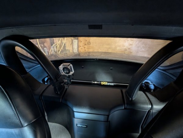

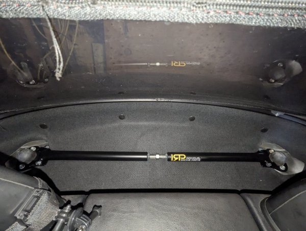

Totally agree, and that is why I did, because down the roadmap I'll be fitting coilovers which need the small reinforcement plates. So instead of the standalone plates, I thought I'd try a rear strut brace, which essentially performs two tasks :woot:

I haven't yet taken my Z to track and check if I can feel any difference and I totally agree that solid bushes are a better performance upgrade.
That being said I've seen up-close firewall sheet metal (which is typically cut in E36/E46 race applications) and I don't think it provides any rigidity. Moreover, in those application they deploy again an upper rear strut brace to add rigidity which is typically connected with the subframe bolts in an X-brace but that is another level.
Finally, since it's a good idea to install reinforcement plates on the rear towers to help cope with harder suspension, it makes sense for those reinforcement plates to be connected with each other. So to me it's a win-win situation adding an upper rear brace for anyone planning to add reinforcement plates.
