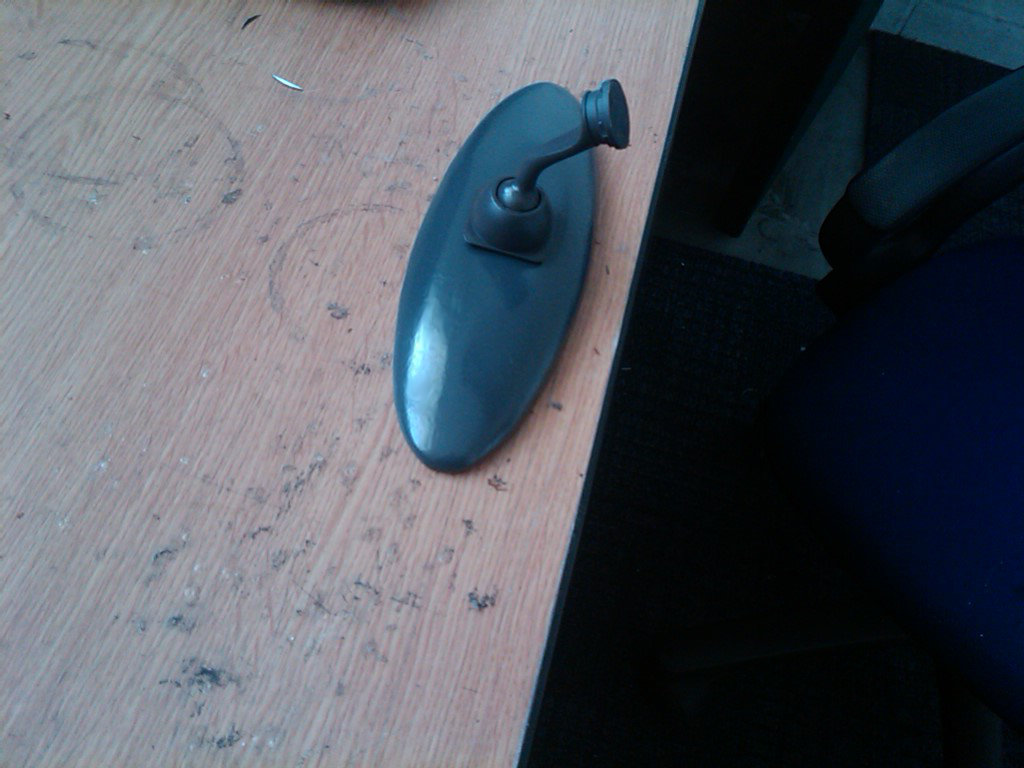

What mirror is that?
home grown, its actually made from card and filler then sealed in rubberized paint, i think i posted a how to on here in the past, think it may have been titled some thing like - mad mods.

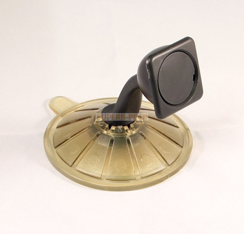

this is the mirror getting fitted up with the mount in the listing, it has the rubber window sucker removed, this was before i realised the ball on the zed mount is the same size as the one pictured here, so it was a simple case of popping it off the plastic tomtom mount and pushing it over the zed mount.

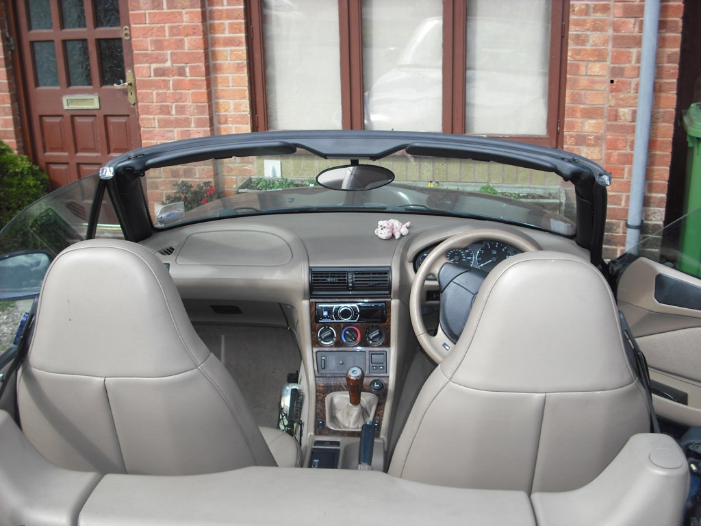

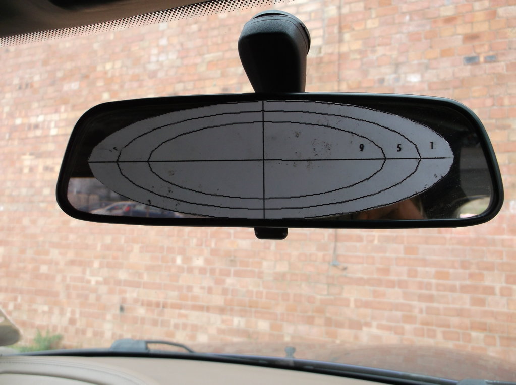

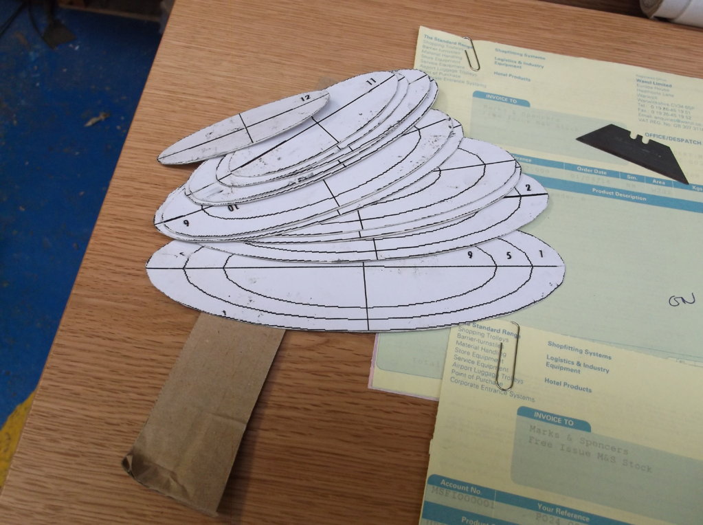

its quite a bit smaller than the original mirror,
in the bottom pic you get an idea of how it was constructed.

Thank you so much for your photo's. I wish I had your ability at lateral thinking to come up with such a clever idea myself. I don't understand why you made templates for the mirror as there are numerous elliptical in the market - is it because the mountings are too incompatible?
