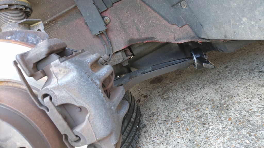

As title,
Needed to replace the (I assume original) Z3 front lower arm rear control arm bushes.
So here goes

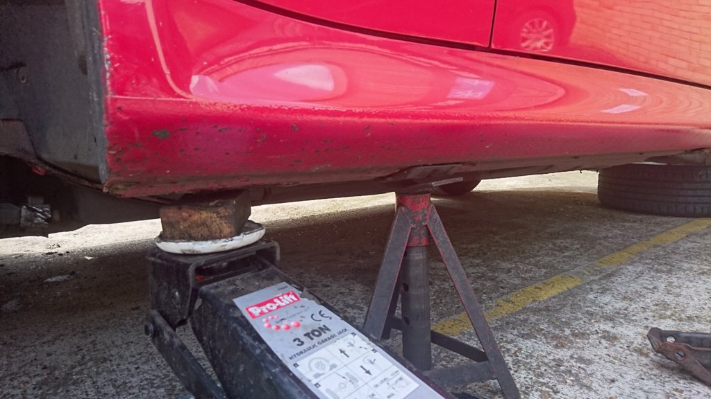

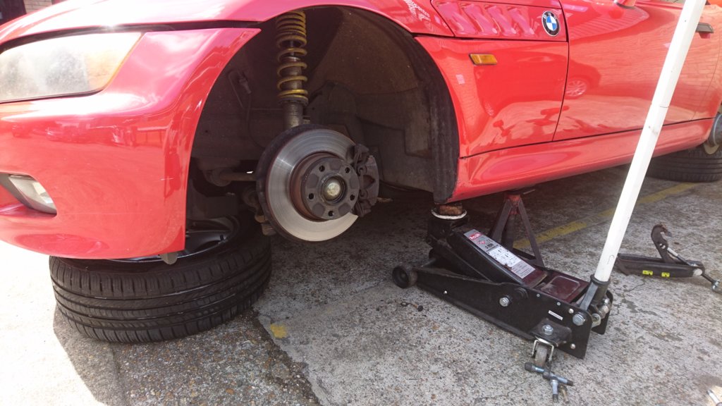

- Jack up car and remove front wheel (this car has been lowered so I had to use the jack from the boot kit to get it up a bit to get a better trolley jack under - as a fair amount of tugging/pushing/pulling is involved I also secured with an axle stand and popped the wheel under the front of the car too)

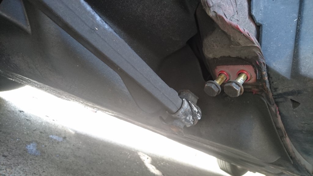

- Remove the two bolts that hold the mount in place (17mm)

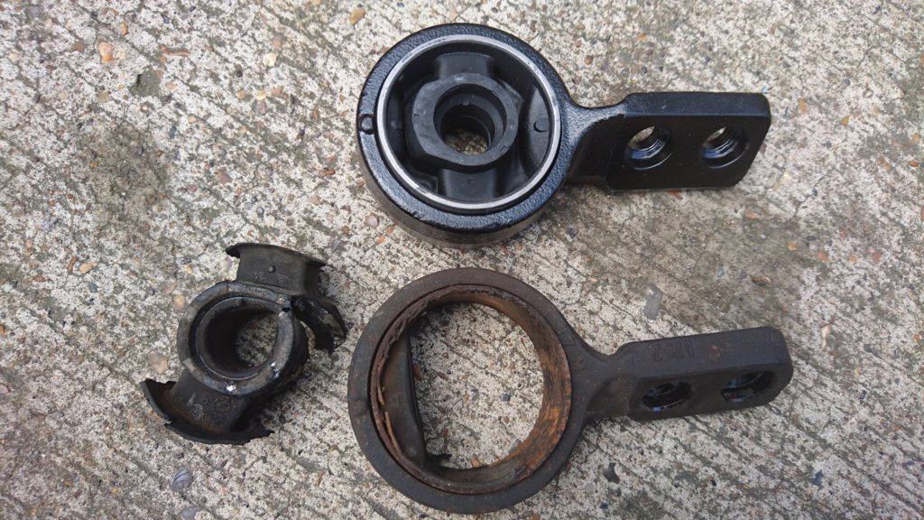

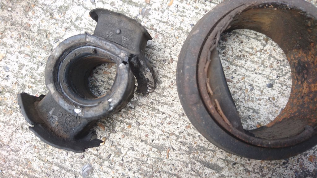

- With the use of an air powered angle grinder the old ones were removed, this is a tricky job and clearly has an element of risk, so best undertaken at a garage.
The old bush can be prised apart with a lever and removed
Old vs new

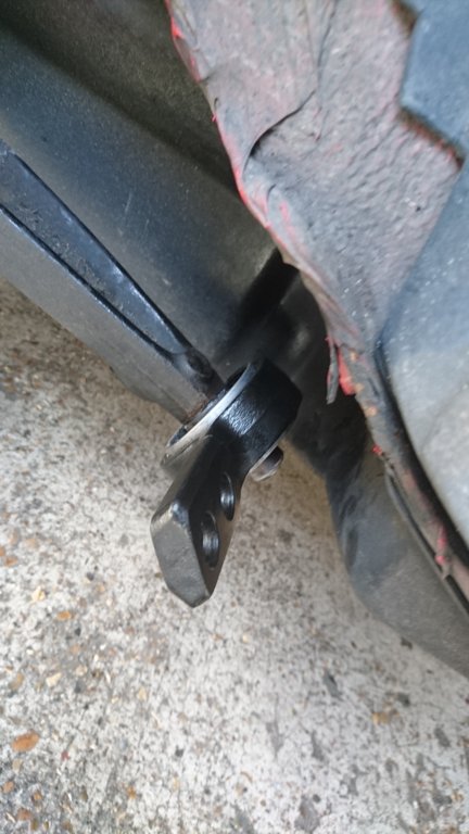

- With a fair amount of elbow grease and a bit of lube push/pull the replacement part on (be careful to make sure you put the correct one on as they are 'sided').
- Do up the two bolts and you are done.
