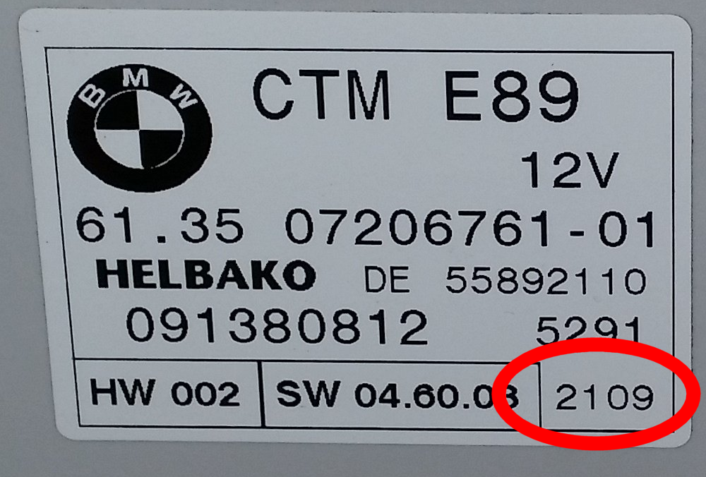

Have a similiar look at the CTM:
Produced in week 21 of 2009
If both components have a similiar age, that should be fine and there might be a problem either with the wiring between the CTM and the 4th solenoid, or the 4th solenoid got damaged in any way.
