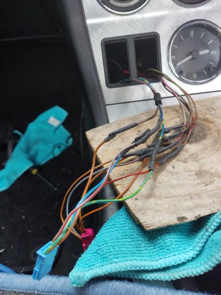

As I had nothing to do this morning after painting a radiator at 4am in the garage.......l sat in the car to look at the wiring for the OBC and Analog clock.....the OBC has a plug with 12 wires and the clock has 3......
So pulled a few bits off the car :eek:
I had written on all the wires when it was out and on one I put a question mark....and it turns out that that one is the clock.
Colours match with circuit diagram.
P
One does get carried away with pulling bits off the car....
There is a bunch of others that are not used but none of those has 3 wires.
The radio was not set in anyway so easy to disconnect and move out the way....but getting the OBC out was a nightmare...and a painful experience....
I have one of those camera thingys, so located where the two screws were and by moving the heater control pod out of the way could get a small screwdriver in and got them undone.....No frigging idea how I will get them back:whistle: Assuming the clock is held in the same way.....
But this explains why the OBC was not functioning... it appears not to have the connector strip that links the pcb to the display......
So it will stay like this till I have a clock to go in.....Not putting an OBC in as they have to be coded apparently....and that sounds way too complicated.......=))

Hi I upgraded my centre to a round clock face lift. I'll try and find some photos. From memory the connectors where diffent but the wire colours where the same and I got it all working fine. Basically just joined similar wires together!
