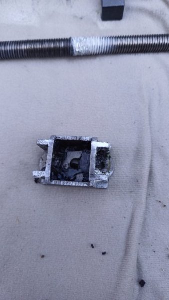

well today in the nice weather i did the seat bushes,
seats are easily removed apart from the 16mm rear bolts needing impact driver...

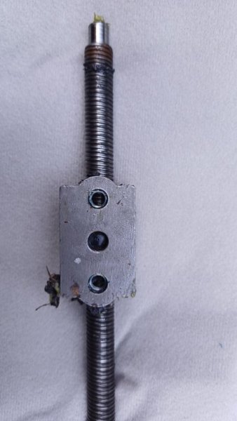

the bushes were non existent, just a greasy sticky glob,
really easy to do, just had to paint mark where the bush housing lives on the rod..

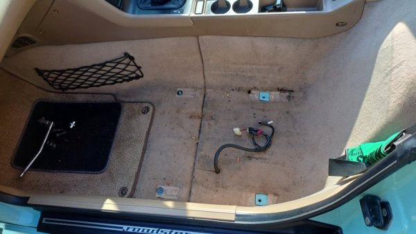

and i managed to give the carpets a proper clean, its amazing how grubby they get when there no access.
took about hour per side.
