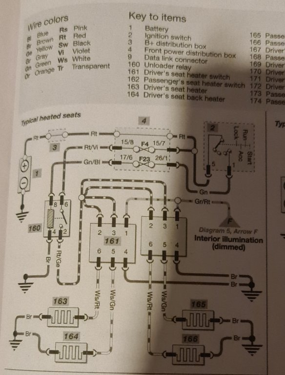

I have just bought a pair of sport seats which are heated and I’ve been informed heaters work. My Zed has not got heated seats although under the seats are a lot of spare wires not doing anything.
what I’d like to know is it possible to get the heated seats to work in my Zed.
I know that I’d have to obtain the switches, what I’d like to find out is in most cars all the wiring is in place when built but if the car is not specked for it from new they just don’t fit things like the switches and may be the fuse and relay and such. So if I can sort the wiring out get switches and and such will the heaters work.
failing this I’m no worse of than now except I will have much nicer seats in the way of sport seats.
any one that can advise on this to get the heaters working would be a great help.
If your zed is after around 97 it should be pre wired for most add ons like you say switching required and without looking possibly fuse and relay but all plug and play just need all the bits :)
This may help
Can you follow this diagram should be roughly right ( I have a e36 Haynes manual that also covers the z3 )
Diagram lifted from there the 2 cars are pretty much similar in a number of aspects.
But going on the diagram 2 fuses ( may be in use for other components one or both ) and 2 switches and 1 relay .

Thanks I’m pretty certain you are correct and yes this will be a great help.
as I say all the connectors are there under seat I’m sure that’s why they are there Just hanging around. I’ve a 98 reg. Going to get some switches and bits then we will see.
if my bum gets red hot then I know something is wrong lol.
