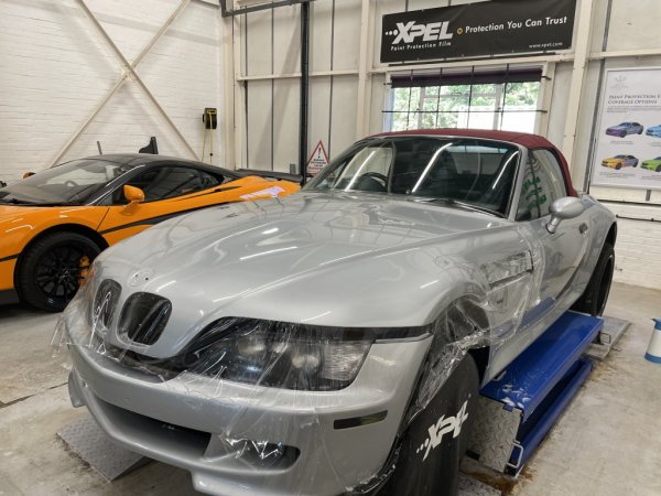

Today’s been such a joy, even though it’s been mega hot it’s still been so rewarding. So first up a few photos from the painters.
The finish and attention to detail these guys give really shows.
Some pre coats
Front bumper, base coat of Artic silver
then the finished coat
Wings
rear bumper
everything we’ve received so far is flawless. So today was a refit everything kinda day, no real assembly photos only the finished article.
Rear
We gave the brakes a quick coat of red but they ideally need fully stripping down.
Front brakes
The bum missing her number plate holder, they still have that and the mirrors to paint.
the red roof works so well.
and the distinctive front end missing its plate.
Still some snags to sort, 3rd brake light Strip needs a good clean up, our resident breaker to the rescue, grommet for the aerial and some other little bits. The rear bumper needs adjusting, the shut lines are all over the place we think it’s a couple of key spacer clips missing. Least these are all little bits to finish ready for collection next week.
Couple of extra photos in direct light.
nice paint finish, ignore the bumper line :)
Those curves
Sassy ass.
Finally crisp sills and no rusty quarters.
3rd brake light is like a disco.
old arm rest removed as it was damaging the centre console
BMW twin cup holder fitted, arm rest due in next week.
then finally quality control gives it the thumbs up =))
I know Simon is chomping at the bit to get his Zed back. Who would of thought every paint shop would be so busy!
