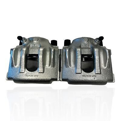

Front calipers are cheap (rear not so) ..almost worth changing them every time you do the pads. They will need to bleed your brakes but labour seem excessive
eBay link

The callipers are different for the 1.9 and 2.8 so be careful with eBay sellers who don’t always specify. The labour charge you were quoted is, what around 3 hours? I’d take that.

Got mine from for my Z4 at Halfords, they had a deal on at the time, I think the calipers were around £35.00 each. My nearside had been sticking, someone on the other forum I belong to said that the discs are quite difficult to warp with normal road driving. It was fine.
