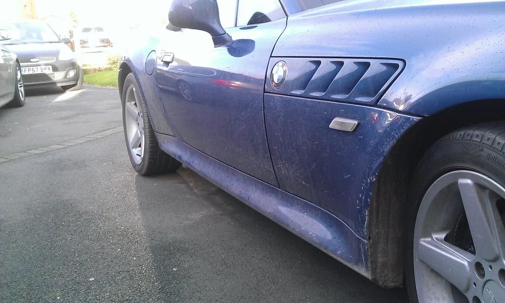

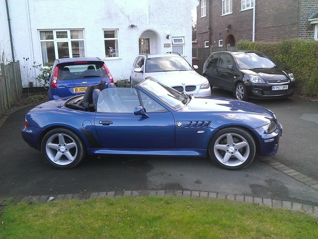

I have widebody pre-facelift with stock suspension.
With perfect fit wheels front: 17x8J ET33 (I believe et34 and et35 would be fine too.)
Not sure about rear, I think it's 17x10J ET33, but you have more room to play with because the different form of the wheel arch...
