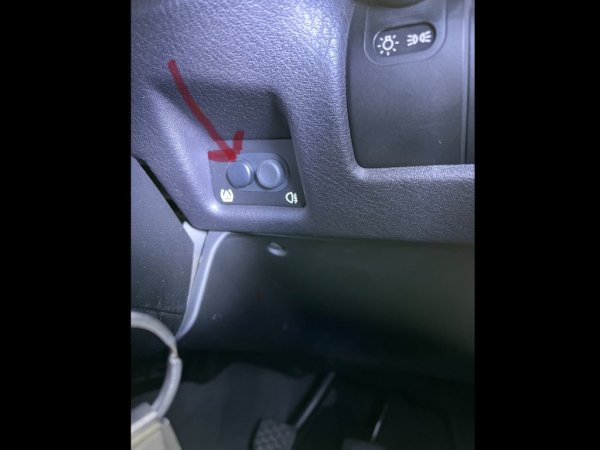

Problem solved. Easy fix. A bit more digging and found the solution in the Manual specific to my car. With ignition on position 2 dash icons light up including the flashing tyre icon. Icons then go off leaving the flashing tyre icon and the red engine icon. All you do then is push the button in (image) found beneath the headlight switch and the flashing icon disappears and is re-activated. When you click it back out a steady tyre pressure icon (yellow) appears on the dash (de-activated).
