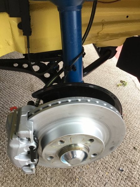

Hello Billy,
i have read your comments with interest, also the good sound advice and comments of some experienced Z drivers.
if you are looking to upgrade your brakes using your existing callipers keeping the cost sensible, please note the following option.
MEYLE have a range of ‘PD pads and discs‘ the pads are heavy metal free (no squeal) and are designed to suit the everyday driver as well as what I would call a ‘sporty’ driver retaining the braking characteristics you would expect from an OE quality pad, note they are not racing pads where they perform best at high temperature. They also produce less brake dust keeping your wheels cleaner longer.
The discs are plain vented discs but are coated and high carbon, the carbon content helps to dissipate the heat quicker than a standard steel disc keeping the disc cooler even under hard driving conditions, the coating which gives no enhancement other than looking good behind your alloy wheels with clean silver hubs.
Please note I work for MEYLE, my comments may sound a little bias because I sell them but my comments are ‘factual’.
if you are interested in them I will send you the part numbers and where you can purchase them.
change the pad sensor whilst doing the brakes, it’s not expensive
fitted on my own car 2.2 Sport. Happy to offer advice when needed.

Thanks Dakar, an interesting option indeed! I'm ideally trying to keep the costs minimal, how much would you expect that route to cost? How about longevity?
Dakar Z3
Dakar
Feb 23, 2020
132
Sunderland
Z3 2.2 , Z4 Coupe 3.0si Auto
Hello Billy
The guarantee is 2 years unlimited mileage, you can expect under normal driving conditions for them to last several years, however this is dependent on your driving style and use of brakes. If you can forward your post code I will find out for you an approximate cost.
