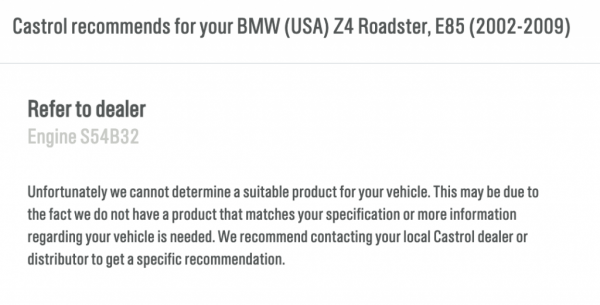

Sorry, I didn't realise you live on the wrong side of the pond. If you check the EU side you get this.

Yes, the owners manual says 5w 30 or 40, but the mechanic videos are mostly 10w-60 as is the Castrol Oil Selector web site. Seeking clarification from those wiser and more experienced than me.
