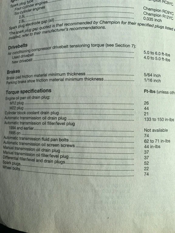

@Faheem showed me how to zip and upload this excel file which may be of some use to other forum members..
He suggested a sticky thread (???) and I understand that is something you have to do. (if you think worthwhile)
Anyway, hope others find it useful.
NB All the info has been gathered from the Bentleys Z3 Service manual and there is a full list, but for those that have an M44 manual Z3 (as I have) then I have separated our specific info onto a second page. (see tab at bottom of sheet)
