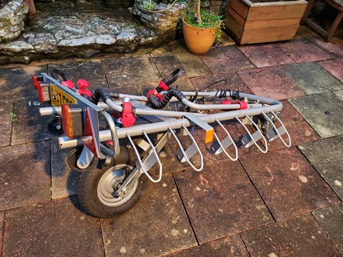

Interesting, but need the tow bar 1st!!Friend of mine who raced mountainbikes had one made by Mottez (French I think)..attached to the tow bar and had a single wheel
edit..found one on eBay
Mottez A352P - Single Wheel 5 Bike Trailer Carrier Tow Bar Rack | eBay
Find many great new & used options and get the best deals for Mottez A352P - Single Wheel 5 Bike Trailer Carrier Tow Bar Rack at the best online prices at eBay! Free delivery for many products.www.ebay.co.uk
I could modify my small erde trailer, but need the tow bar 1stYou could easily make a bike carrying trailer under.the towing weight limit. I made a boat trailer for a friend back.in the day.
