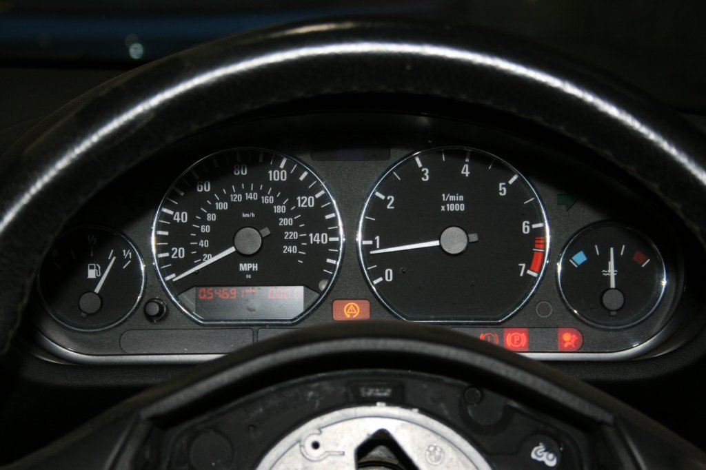

Today I decided to get the Z3 running again, as it hasn't turned it's crank in over 6 months. Last time was when a friend (from another forum) overhauled the vanos, changed the oil and filter, brake fluid, etc. I also put new plugs in at the same time; that was in early November.
I checked all the wiring changes I have made so far and taped the ends of anything I overlooked just in case.
Stuck the charged battery back in and connected it up. Interior light came on so thought happy days. I taped some elephant trunking on the exhaust and routed that out the door.
Turned the key to the second position, the dash lights flickered on then all went dead. Everything!
I spent most of the day checking every fuse on the car (there are a lot. None had blown), checking all disturbed wiring and then scratching my head. Turns out for some unknown reason the earth post to the battery didn't tighten. I used a 10mm socket and it got tight but didn't tighten the earth post. I had to remove the earth post and cable and sort it out on the bench. A new M6 S/S nut was need on the post but I still don't know why!
Re-assembled it and put it back on the car. Connected the battery back up, turned the key and she fired up instantly! :D
I warmed her up for about 30 minutes and checked that everything else on the car works; heater, heater fan, lights, etc. Even the A/C runs but does need some refrigerant.
The engine runs like a dream....I have put a K&N air filter on as it is impossible to get access to the OEM one when the body is on. With the rasp of the intake allied to the exhaust rumble of the M54 3 Litre it is music to my ears.
The day went from terrible to great. Cars are so fickle when it comes to earthing!IMG_9421.JPGIMG_9424.JPG

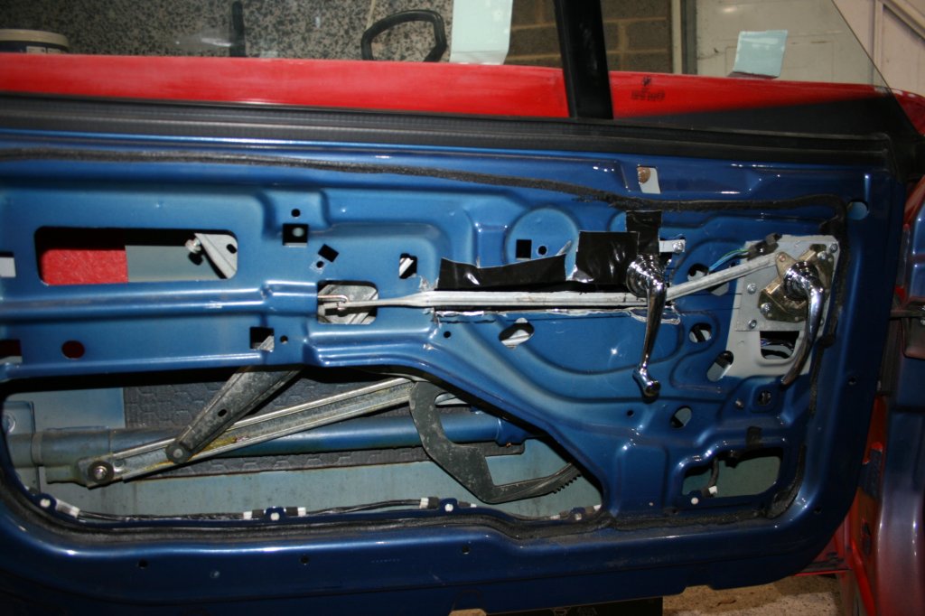

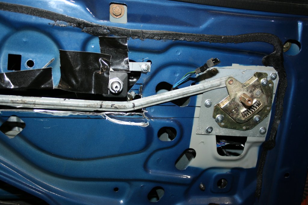

I have installed the interior door openers and connected them up to the Z3 rods. I have adapted some 2 way momentary switches to fit my period window winders, so the electric windows can still work. The wiring will be taken from the old mirror feeds and spliced inside the cabin.

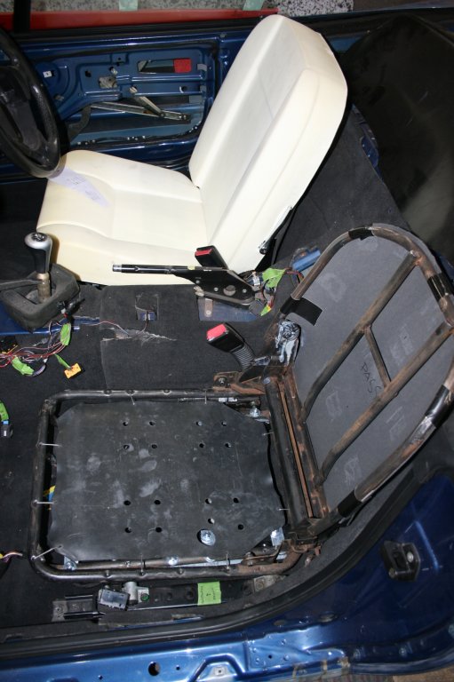

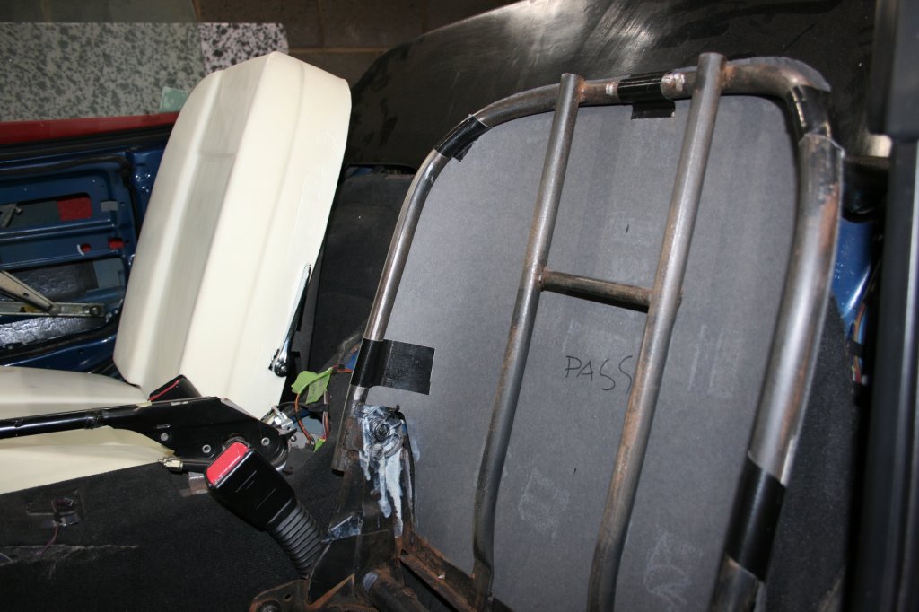

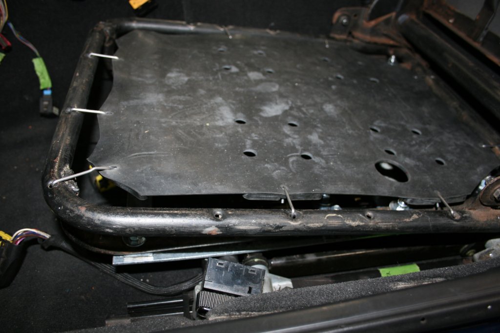

I have also adapted my old MGB seats to fit on the electric Z3 seat bases. It was quite tricky as they are a tight fit and have to move straight!
I put new diaphragms on the seats (what a PITA that was) and new backing boards. I have new foams which will not be glued until upholstery time.

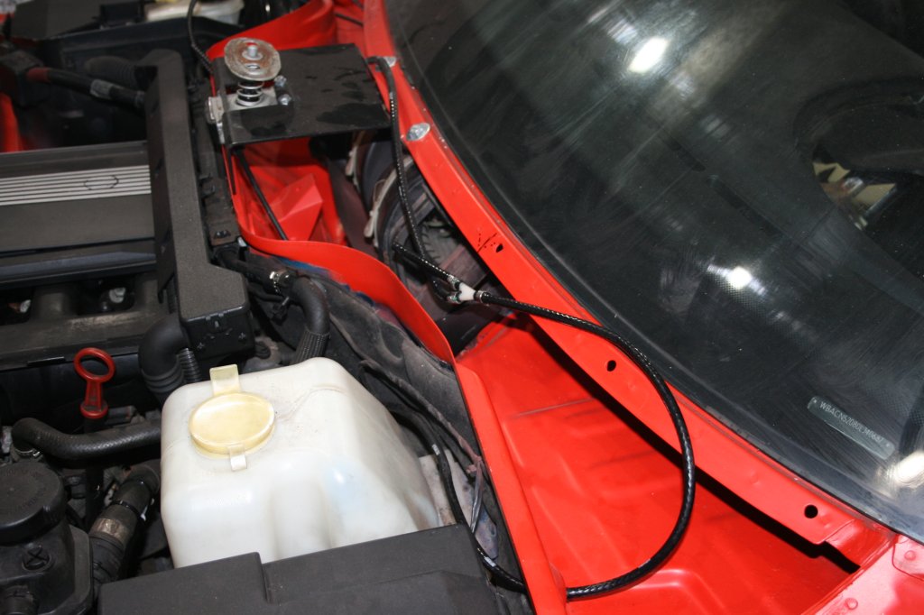

Also diverted the windscreen washer hoses and cut them to be roughly in the correct new place.

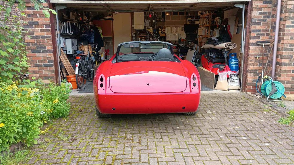

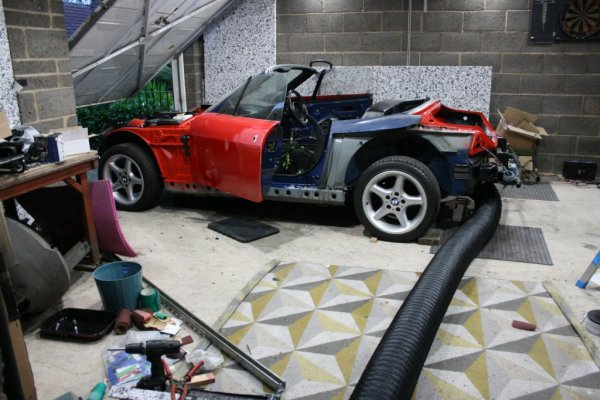

I really want to get the body sorted and glued, but every day it is forecast for showers. I can't put the body on in the garage, as the body panels are too long (and it will be tricky getting the body through the door).
159
Pontrhydyrun - in Crow Valley
Your garage looks huge. I wish I had that much space.
Wide angle lens mate. I bought it second hand off an estate agent! ;)
The width is fine, it's the length. I have a full width bench just out of shot. Because the sills are almost full length to the A pillar, I need to 'slide' the body on from the rear. There isn't enough room. I checked! :)

I was trying to zoom in on your picture of the door opening catch. How it connects to where the old Z lever was.
Pond
Dec 26, 2016
144
Spaldingski, Lincs
Z3 project and E89 Z4
The spring latches (which I got as part of the kit. I think they may be from an MGB?) have a solid bar, which I have had to bend and twist to orientate it correctly. I then cut the excess off and drilled a 5mm hole to hook the Z3 rod into. I had to drill two as the first one didn't quite open the door latch!
I hooked the bar on, then marked the spring latch, then used self-drillers. The back plates are bits of steel cut out of the surplus rear wings on my bandsaw then straightened with a big hammer. See...I'm getting the hang of this 'kit car bodging' malarkey. :D

Is the car mobile? Can you drive it out and in the garage? The doors go on first but with temporary fixings, then the back is put on. Turn the car around and then you can move the back body into the garage and onto the car. You seem to have more room than I have!
Yes the car is mobile (now I have a seat). I have a double driveway BUT the only way to get the body parts either into the garage or onto the driveway is through a pedestrian gate or door. The body is in the back garden and I have 6ft brick walls between that and the drive. So both body parts need to be taken through 'on end'. My wife will NOT keep doing this every 5 minutes. She also works full time (I don't anymore). I also am worried about damaging or cracking the GRP.
I also have to move the other two cars on the drive to get the Z3 out (with the body) onto our remote parking area. That is mostly taken up by my daughter's Mini. It is a logistical nightmare.
I have a friend who will come up for a day (or two) to get the body in and out and on/off, but I can only do that if the there is no chance of rain. That is proving a problem.

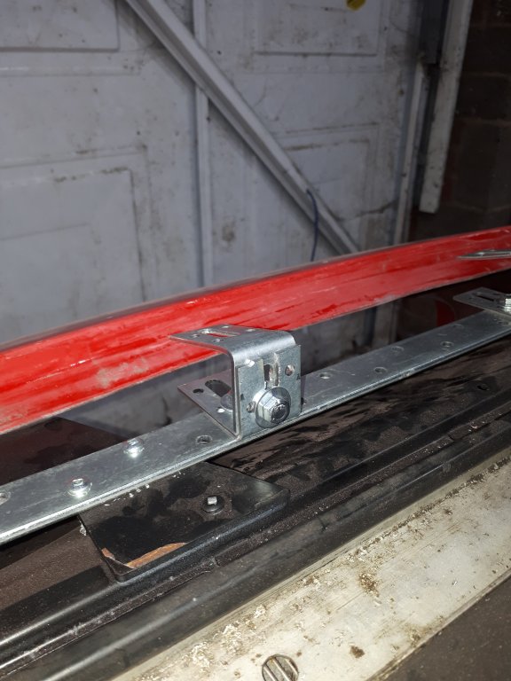

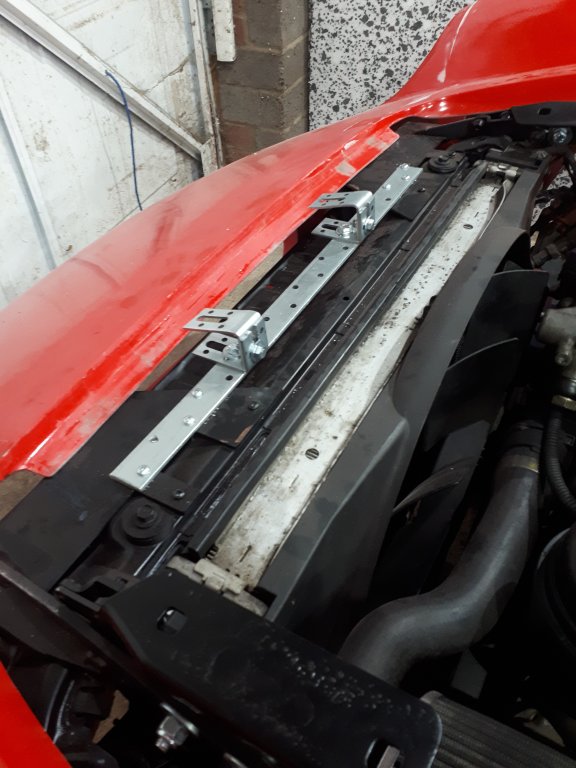

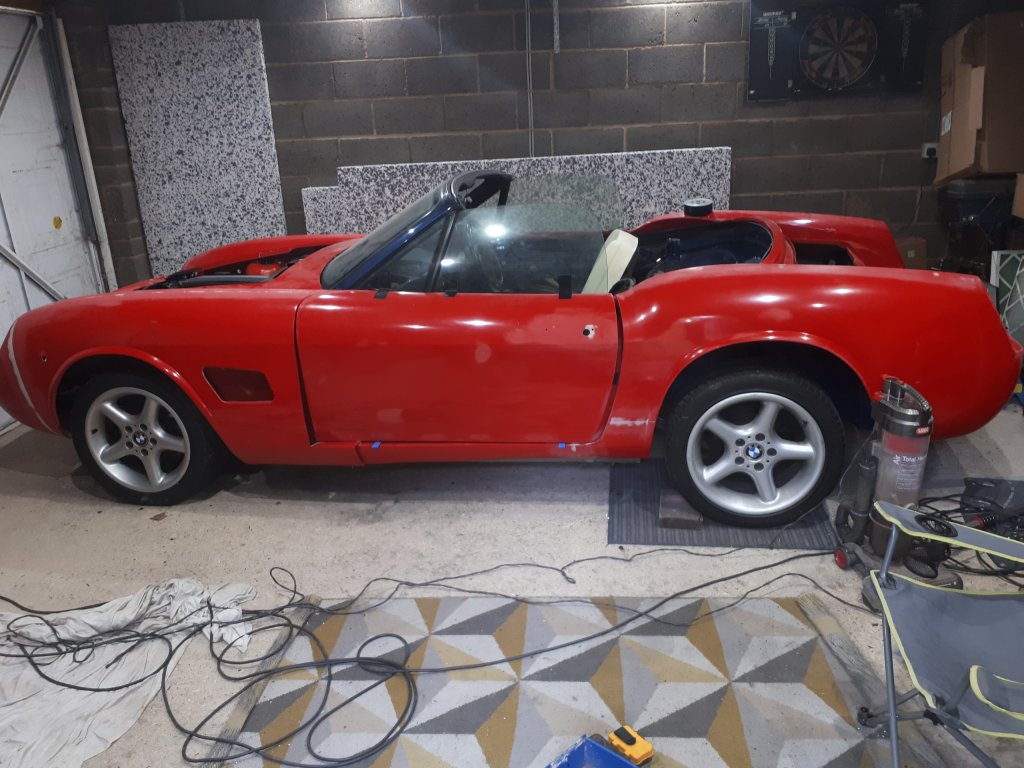

So after leaving the car alone for the last couple of weeks (because I was getting so frustrated with nothing fitting, not being able to do A without doing B, or C, or X Y Z, etc), I have calmed down and got my head back straight.
The body is on but just resting where it touches, so I can start to work out what needs to be trimmed more to get it to fit correctly.

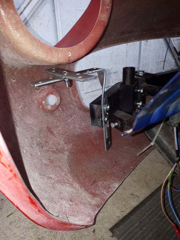

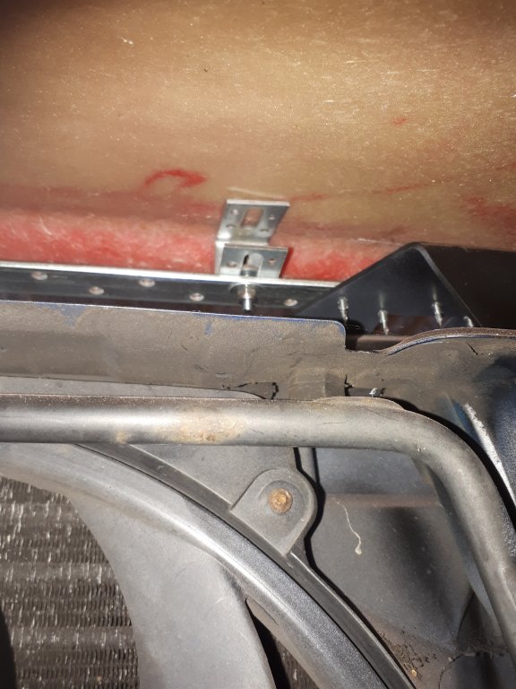

As my kit didn't come with most of the support brackets to bond the body to, I have had to make some. The front corners are supported by brackets which are supposed to sit under the headlight cowls. On the original DNA kit, these were in the form of 'turrets' on threaded rod which could be wound up and down. I don't have those, so had to fashion something to do the same job. My front bumper brackets are not wide enough to put these 'turrets' in, so I have fashioned some bent straps which are slotted so can be adjusted up and down. These are the revised versions, as I made some before the body was put on but they were miles too short and didn't reach the headlight cowls. They sit at the same angle as the cowls so should bond well all the way along.
I also had no way of raising the front body away from the radiator top and bonnet brackets, other than relying on the above headlight cowl brackets. That would have meant the whole front piece would be just swinging in the breeze. So I spanned the hinge brackets with some strap and made a couple of adjustable brackets to support the front end. These have been bent to match the angle of the GRP to get a decent bond.
I can now 'tilt' the front end to adjust the panel gaps on the front edges of the doors. The only worry I have at the moment is the difference in profile of the nearside door skin to the 'wing'. The offside is much better.
As it stands at present, my swage lines are almost spot on so don't want to alter anything to compromise those.
