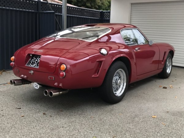

Thanks for the info. I completed a Tribute 250 build for someone and fitted the Technix adjustable coil overs. They’re ok for the money but they wanted to get it a little lower and maybe slightly stiffer springs so happy to spend a bit more to get the ride height right. I did the camber kit already when the rear end came out for refurb,new bushes etc.There’s lots of ways of dropping the zeds, most will depend on what you plan to do with the car. If you want coilovers and don’t mind compromising the ride the BC’s are the best value for money, the build quality of these is great. If you want to keep the nice ride you’ll need to look at KW coil overs but these normally start around £1300+
Plenty out there.
Really nice finish there. I say exactly that to a everyone who wants to covert the Z3 platform. It needs to be lower to look right and to do it you’ll need a camber kit to straighten the wheels up.Thanks for the info. I completed a Tribute 250 build for someone and fitted the Technix adjustable coil overs. They’re ok for the money but they wanted to get it a little lower and maybe slightly stiffer springs so happy to spend a bit more to get the ride height right. I did the camber kit already when the rear end came out for refurb,new bushes etc.
