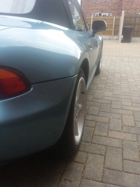

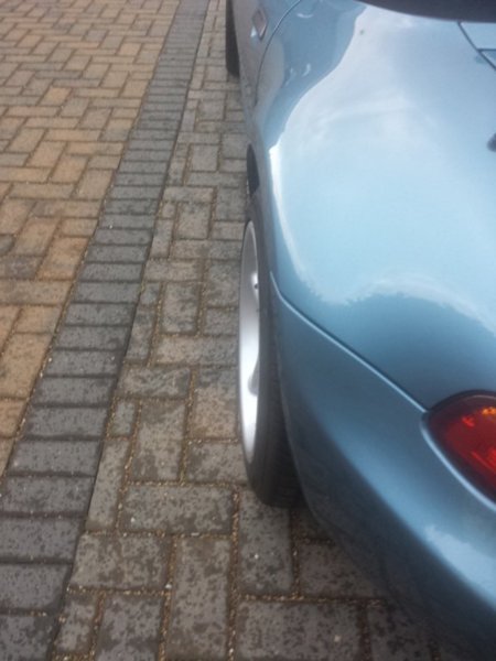

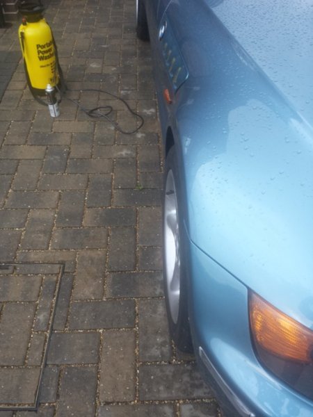

Ive just spaced the rear of my 2.8 running standard 7.5 front and 8.5 rear with offset of 41 i found although a 20mm spacer fitted fine on the rear it was just a tad too much. The fronts unspaced sit a few mm inside the arch lip and 20mm on the rear made the tyre/wheel just sit alittle outside the arch no biggy but at 15mm the spacing matches the front perfectly so looks stock and a lot better.
I liked the look of the rear spacing but my ocd would have had me having to get 5/10mm spacers for
the front so it all looked the same. :)
Rear before
Front non spaced
Rear spaced @15mm
