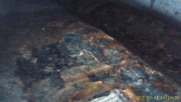

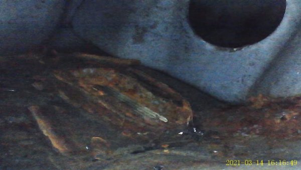

Picture of tube Malc ?Inner sills treatment today.....
RC900 spray. A 400ml can just enough to do both sill cavities. The nozzle with the long tube was an extra 3.99, expensive ...but worth it to get a decent coverage inside the sills.
I took some pictures with my endoscope before and will compare tomorrow with the after effect once its dried.
Then go over the external areas again with some FE-123.
