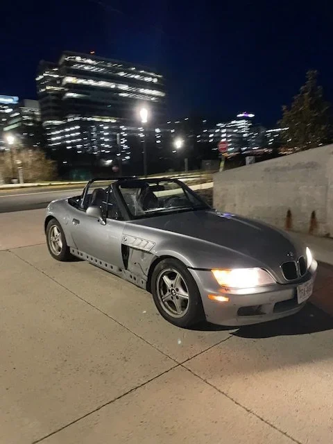

A while ago I bought a ’96 M44 roadster, 5MT. It was a pretty rough example, but I made do and carried on with the “restoration.” I put a ton of money into rebuilding the front suspension, added a Bilstein B12 Pro suspension kit, new slotted and drilled rotors and pads, and a bunch of random things like sourcing interior trim pieces to rebuild the degrading interior.
I replaced the oil filter housing gasket, spark plugs, and redid the entire cooling system. Funny enough, I was never able to get the heat to blow hot. I even replaced the wiring for the climate control knobs, heater control valve, flushed out the heater core several times, and made sure the vent flap door was functioning—still no heat. Ah well. It did blow cold though, which was nice in summer.
When I bought the car, the entire rear trim was missing—but that ended up working out because I installed a Hard Dog roll bar, and with all that trim already gone it made the job way easier.
I also replaced the passenger side window/top rubber seals (those little rubber pieces love to pop off). Then I dropped the exhaust and driveshaft and rebuilt the shifter linkage, adding some Garagistic poly bushings. Man
 the shifter felt amazing after that. Unfortunately, that’s when I noticed my second-gear synchro wasn’t very happy. Aggressive downshifts into second wouldn’t even engage—I’d have to try a few times to get it in (hehe). So that was
 unfortunate.
I also added Condor Speed Shop poly engine mounts and transmission mounts. That definitely added a lot of NVH, but you know
 race car things. I even swapped the stock black center console for a wood-grain one.

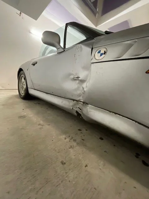

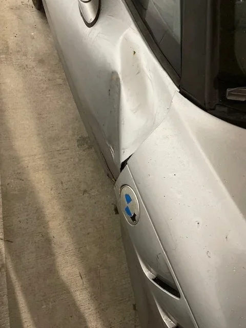

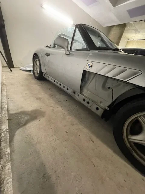

UNFORTUNATELY, one day while the roads were wet and my tires were bald, I went a little too hard around a corner and ended up becoming very acquainted with a tree on my passenger side. Lol.

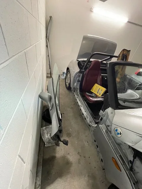

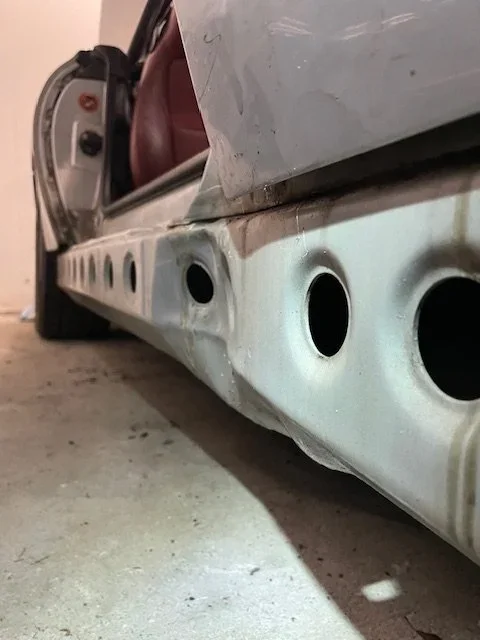

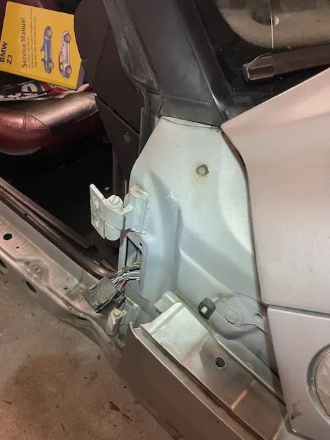

The passenger door was cooked, the lower rocker was donezo, and the windshield cracked at the A-pillar. I was able to drive the poor 1.9 home, and luckily none of the driving aspects were affected—no leaks, still starts right up. However, once I removed the passenger door and lower rocker panel, the true damage became evident. The chassis was dented to hell, and the lower door hinge had been pushed inward so far that even after finding a color-matched replacement door from a junkyard, it would no longer align.
The A-pillar had shifted a few millimeters—just enough to crack the windshield and prevent the top dowel from lining up with its hole. That meant I could never properly close the soft top again.
I took it to a body shop for a quote: $2,500 just to pull the hinge and A-pillar. No painting, no extras, and no guarantee that things would align properly afterward. Not to mention that after replacing the windshield, there was a good chance the first pothole I hit would just crack it again since the A-pillar was no longer in its factory position.
At that point I decided I’d be better off putting that $2,500 toward finding another chassis—maybe another 1.9 in the same color (Arctic Silver is pretty common). My thinking was that if I found one with a bad engine, I could just swap all my good parts over and be back where I was.

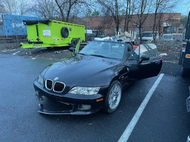

After a few weeks of checking Copart and Facebook Marketplace, I found a potential option:

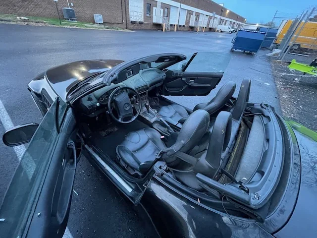

A 1999 2.5L inline-6 Z3 roadster with 60k miles, black paint, black interior, and black sport seats (SCORE!!). It also had 18” M-badged wheels (I suspect they’re reps
 but that’s fine with me). The interior was very intact too—rear compartment, hoops, all that good stuff.
I was able to secure the deal for $2,300.

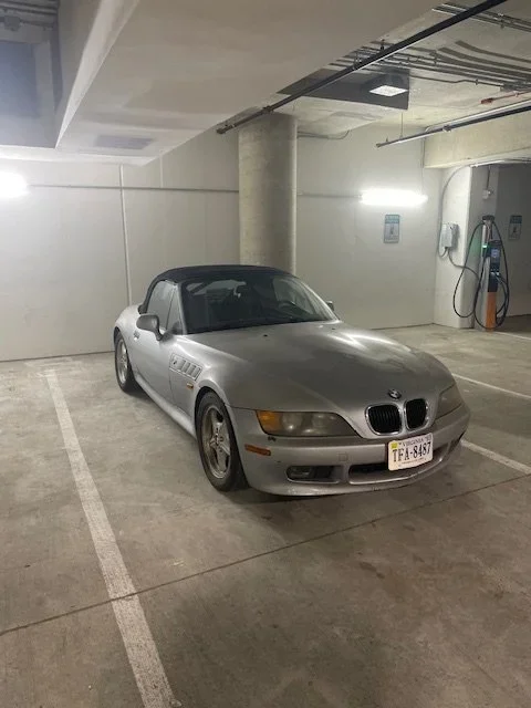

The bad part: it had clearly been sitting for a long time (I suspect something like 16 years

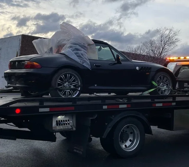

 wow), though the seller couldn’t confirm. I had to bring my own battery, and once I hooked it up the car started coming to life electronically. I didn’t try cranking it though—the oil was bone dry, so it had clearly leaked out over the years.
The tires were completely dry-rotted, so I had to tow it out. The rear window in the soft top was also totally gone, so I had to buy a car cover as a temporary solution since I don’t have covered storage right now.
Oh—and it’s automatic (darn).

yep this will occupy my free time over the spring/summer for sure. On the wheels, any idea if they are genuine bmw wheels? I haven't been able to ID them hence my suspicion that they are reps. Either way they do look cool.

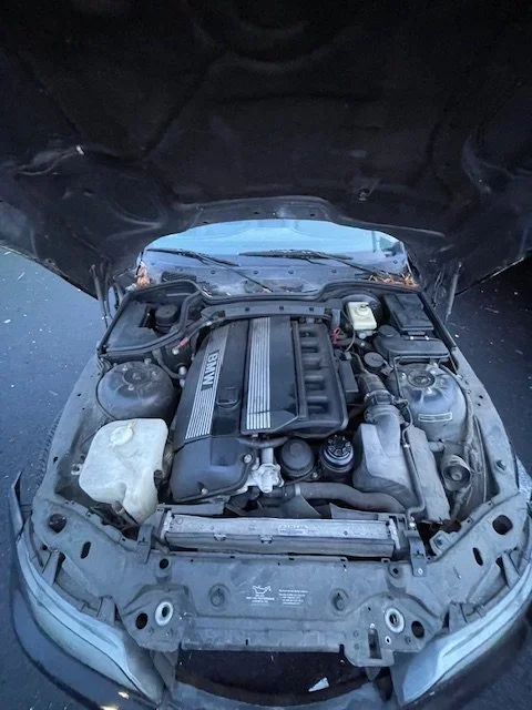

Alright so I finally got around to trying to start the 2.5 m52tu after doing all the basic revival stuff. Fresh oil and filter, new battery, new intake boots and air filter, cleaned the MAF and ICV, dumped some oil and Marvel Mystery Oil into the cylinders and let it sit for a couple days, new spark plugs, coolant flushed and refilled. i took the fan off and turned the engine by hand to make sure it wasnt seized- it turned very easily and felt right. So at that point i was ready to give it a try. I put some fuel cleaner in the tank and then some 93 octane.
I pulled the fuel pump fuses and cranked it a few times to build some oil pressure. Put the fuses back in then tried again, nothing. Hit it with some starter fluid and it fired right up and sounded good, but only ran for a couple seconds before dying. Did that a few times and same result every time.
It also blew a ton of white smoke out of the exhaust, which I’m not too worried about since I soaked the cylinders beforehand. Figuring that’s just everything burning off.
So at that point I started looking into fuel. I don’t hear the fuel pump priming at all when I turn the key, which already had me suspicious. But then I noticed something else. With the key in position 2, the dash does its normal thing for the most part. Oil light, brake, low fuel, ABS, seatbelt, all that comes on and then some of it goes away like it should. But there is no check engine light at all. Not even for a second.
From what I understand that’s not normal, and it’s kind of pointing me away from just a bad fuel pump.
Where I’m at now is thinking the DME isn’t powering up. That would explain no fuel pump, no fuel delivery, and why it only runs on starter fluid. I checked the fuses visually and tried swapping the relay in the DME box, but it didn’t change anything.
So currently I’ve got a car that cranks strong, will fire on starter fluid and sounds fine for those few seconds, but won’t run on its own and has no CEL in position 2.
Next step is to make sure I’m actually hitting the correct DME relay, try swapping with a known identical one, and check for actual power at the DME-related fuses instead of just eyeballing them.
Feels like I’m close, just need to track down why the DME isn’t waking up.

Dont get ahead of yourself here fuel pumps are a common failure.
So is removing the engine check lights bulb on dash to hide a fault.
First thing get a code rwader and a 16 to 20 pin bmw obd adapter do a cide read see what if any there if reads that thats a good start that ecu has comms
Behind the drivers seat you will see a circle half cut out you need to complete the door then behind that you will find the fuel pump / sender until check for power
Pulse on ignition stage 2
Continuous on crank.
