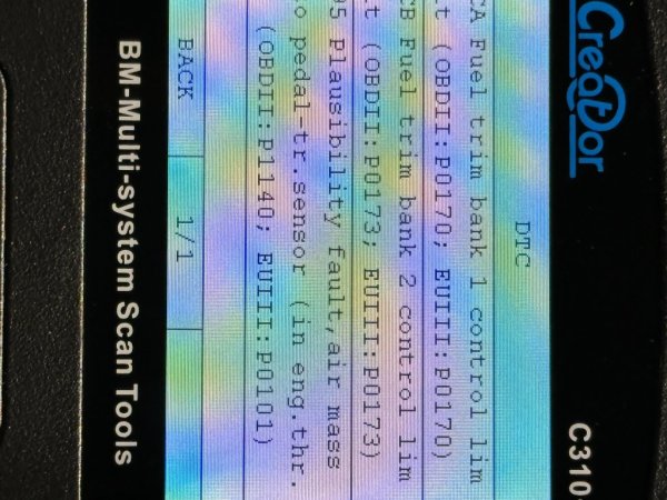

Are your fuel trims indicating rich or lean? Knowing this will give you the direction where to look next. Sorry to say, diagnostics are often time consuming and frustrating but ultimately satisfying when finally resolved. Remember, your engine has three simple requirements: fuel, air and spark. There's still a lot of things that need to be checked (and re-checked).
Also, running the vehicle for long periods in this condition can damage the catalyst - sorry again.
I thought the sensor showed those trims but I couldn’t find any setting.

With no other information, the indications are that your engine controller has determined that the airflow into the engine is not as expected. This would affect the fuel trims, going to maximum in the event of excess air (i.e. leaks) or minimum in case of restrictions in the intake path. Of these faults, air leaks are by far the most common. It appears that you have performed a smoke test to look for leaks but have not yet detected any issues. You may wish to try an alternative method of leak detection, such as the cautious use of a flammable aerosol (e.g. brake cleaner) around any likely source of leaks (e.g. all rubber hoses connected to the intake manifold, IAV, PCV, brake booster, etc. etc.). If you create your own small leak you can see how this detection method works - spray near your leak and after a small delay the engine note should change. If your Creator tool has a live data display you could also use this rather than relying on ears. That said, eyes and ears are good tools for this exercise. If you can't find any leaks then try again. If you are certain that there are no leaks then try again, spraying different areas. Finally... you get the idea.
You are currently at step#1 of the diagnostic path, there are plenty of other paths to take once you're certain there are no air leaks.

Thanks for the message.
It has been smoked several times. @Lee gave it a thorough check a few weeks ago. About 4 of us also watching for tell tale signs.
The other symptom is a very rich fumey exhaust while cold.
