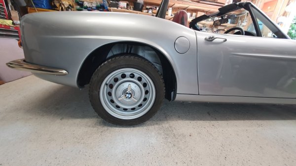

How did you 2 get on with your wheel liners on the 507.
I've got the rear ones done and am reasonably pleased with them. Nice snug fit.
I cut the raised section out and plastic welded it all flat.
Front ones though need loads of work. I'm thinking of cutting the flared piece out and extending with thin sheet fibreglass
Having a new hood fitted on Thursday and was hoping to have all the wheel liners in.
Piran
Oct 21, 2022
41
Heat gun, bits of wood and g clamps and I've smoothed the fronts out, it's not brilliant but it'll do for now, I just want to get it on the road now and I need door handles for that 😞

Hi all,
I'm pleased to say that my third iteration of the handle has turned out well. The video can be downloaded from our website, please follow this link, click on the link, download the zip file and unzip the video
Everything works as expected although I have a bit of checking to do on the version with the turn key.
Next thing for me to do is to mount the handle on the door and to mount the cable guide on the end of the door panel so that I can see everything working as a full system.
I've got a couple of areas that I'll tweak for the full production version but basically I'm happy that this does what it was desogned to do. After I've tested everything I'll be happy to send the pair of handles off for polishing and make them available for purchase. And after that I'll take a bit of a breather whilst I make the minor adjustments for the production version.
I'll then make them available on our grassbankconversions.co.uk website.
I noticed elsewhere in this thread discussions of wheel arch liners. We have our own fibreglass liners which I've got fitted on my 250 Califormia and which Justin has on all three of the 250 Coupe's that he's built. We made them a bit wider for the Cali but they are easy enough to trim with an angle grinder. They're also made in black fibreglass now.
Looking forward to answering any questions.
Russell
