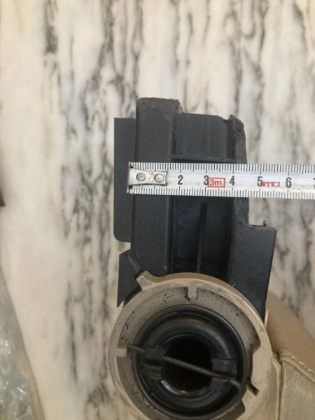

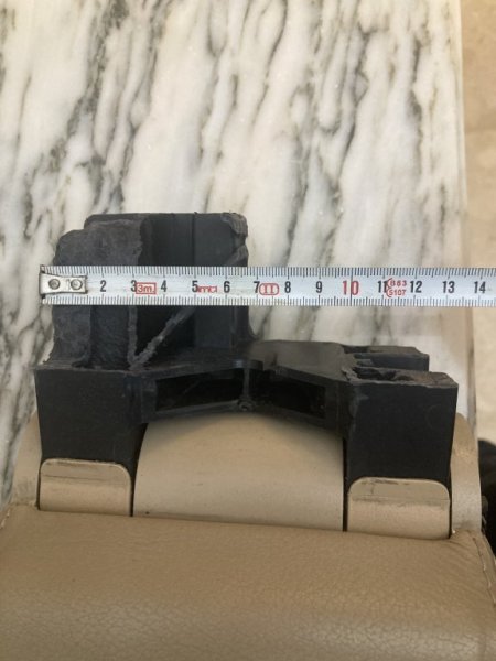

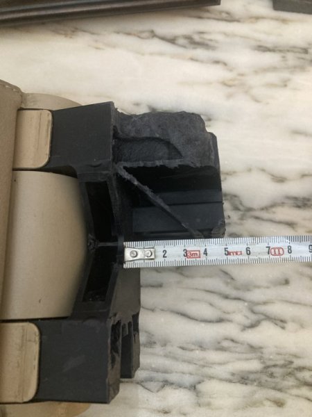

Can one of you pros please provide the measurement from the original ledge to the lower leather cover of the armrest?
(And also the width of the notch removed on the back)

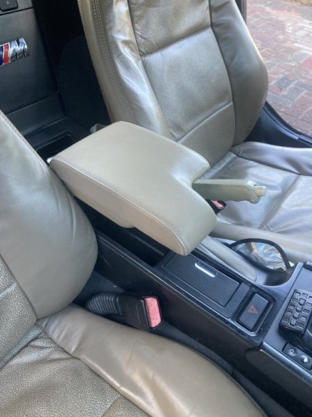

Ok - went for it with a LHD.
So far so good. I made it higher than Sean not to interfere with my handbrake and will now try with silicone as did not want to dismantle the console. Hope it holds my light elbow.
Note that it is artwork to get the angles and corners right. Hacksaw and dremel.
Note that for a RHD the dimensions are mirror image - but should be the same. (The 5.0cm dimension would be a better fit if it’s a bit bigger about 5.2. Basically work down to the dimensions in the images until the fit is snug. The notch in the rear is important for 2 reasons: to provide another ledge for adhesion and to enable the easy removal of the handbrake boot)
Note that had to tighten up the handbrake cables so when pulled up it didn’t reach the armrest.

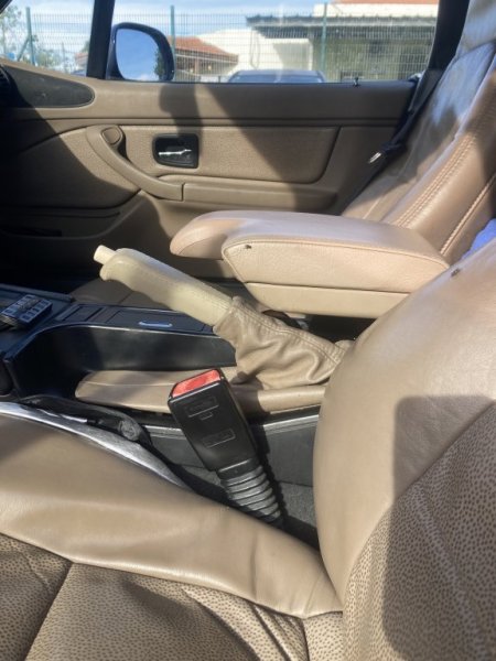

I used the Dutch Super7. Looks good.
I’m waiting 48 hours before I put it under stress. 36h so far 😏
(I’m confident in will be ok over the winter. The question is what’ll happen in our summer heat).
If one has able hands it’s definitely worth the effort. IMO puts the interior in a different league. This is a super option if you don’t want a z3 cup holder. If you have one, there is much simpler solution. Just buy a replacement e46 top armrest (a few bob on aliexpress), remove the two ears and silicone a plastic hinge to the back of the cup holder.

The Hybrifix Super7 did a great job. Solid as a rock. I sense getting a good fit with all the angles makes a difference.
I suspect any decent silicone would do the job.

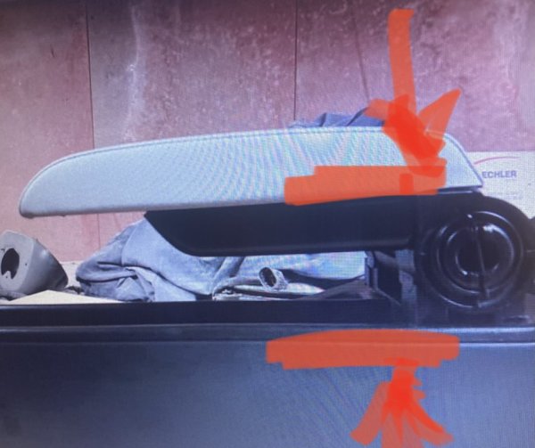

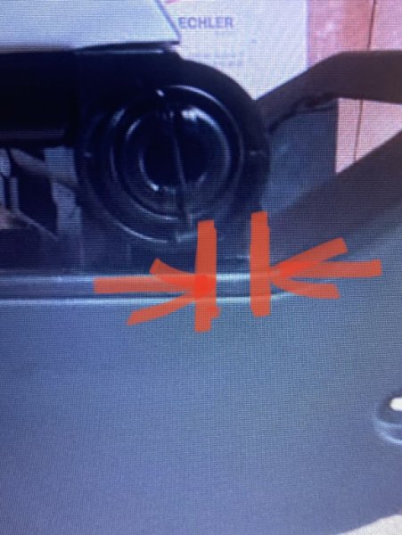

Test fitted today(was Baltic)going to cut down again and angle the back...not sure if I should re-colour red

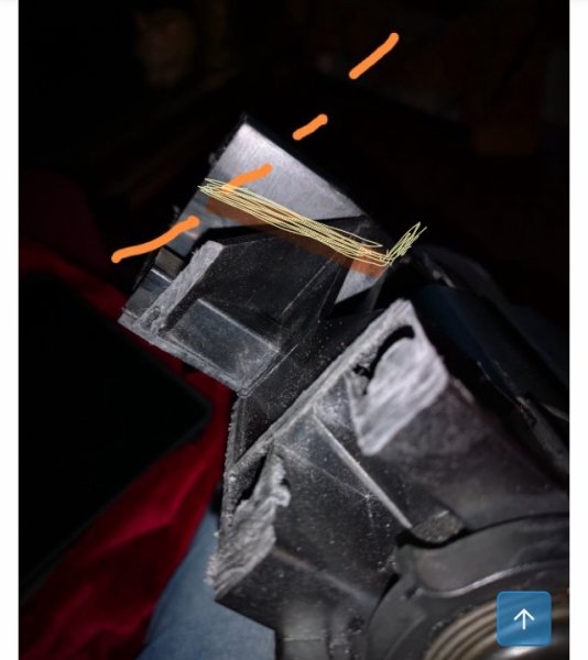

Looks great - although I don’t understand how it is so far back considering in the pic it seems you did not cut out a notch to get another ledge for adhesion.
Rictic60
Jun 4, 2022
46
Thanks I'll have a look at that...its not fitted yet and far too cold to hang about ..planing to bond and use self tapping screws
Looks like it's always been there. Top job.
