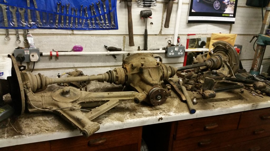

. Please keep posting pics.It's easier with two for sure, but you could with enough motivation do it on your own. You won't however be able to lift it on to a work bench on your own, it's bloody heavy! Of course you don't need it on a bench to work on, it's just much easier to do so.When removing the sub frame is this a 2 x man job??
@Nifty Fifty get yourself a fork lift......You won't however be able to lift it on to a work bench on your own

IMHO, he must have a set on him to show this on a public forum, that 'thing' was an accident waiting to happen by the looks of it.This leads us on to some more pictures of a fairly graphic nature. I'm hoping Duncan doesn't mind this being a warts and all post, but this is what we have found![]()
Actually the reason she was laid up since coming back from the London to Brighton was that after I had fixed the problem with the water pump failure I could tell that things were not right so she has been laid up since in the middle of a field (all be it on hard standing not mud) I also live very much in the messy countryside. If you take out the muck issues the main thing that was a safety issue was the current issue with the brakes. Most of the bushes had just gone through the MOT before the London to Brighton at which point she was handling fine. I was aware when I checked her over for London to Brighton that the Diff Bush was starting to deteriorate but at that time the brakes were "fine" from an MOT point of view but I knew things were wrong because of how Black had handled on track. I was also aware of a small leak to the front struts which is why they are already lined up to be replaced. After the L2B she was out in the weather not being used for 5 months and not under cover either on the top of a hill so I was expecting problems. It is also one of the reasons why she was trailered up to Lee and Gaz. So it was never an accident waiting to happen but it was a very DUE process to get her looked at and I had spoken to Lee and Gaz many months ago about the possibilities of it getting done.IMHO, he must have a set on him to show this on a public forum, that 'thing' was an accident waiting to happen by the looks of it.

I think it's worthwhile you mentioning it's been laid up for some time, I didn't explain that although I knew and forgot. Also as Duncan says the car was trailered up to Basingstoke rather than being driven, so it's not in daily use.So it was never an accident waiting to happen but it was a very DUE process to get her looked at and I had spoken to Lee and Gaz many months ago about the possibilities of it getting done.
It's always tricky deciding when to pass a car on, but what I have learnt from the last year in the Zed Shed is that despite their ages the Z3 is pretty solid underneath. Replace all those failing bits of rubber, treat the corrosion and they should easily last out a long long time. Lets face it the early ones were made in 1996, and even the youngest are now 13 years old.I did wonder about moving Blue on and replacing her but It sort of seamed a bit unfair to the car.
I think it is important too, Though I am worried now about how much muck gets ON TOP of things like the rear beam where I live, I am building a shed to store her in out of the weather but living where I do in the mucky countryside may always be a problem.Documenting the process like this is one of the things I like about the stuff we do, so that it hopefully gives others a bit of confidence to tackle some of these jobs themselves.
