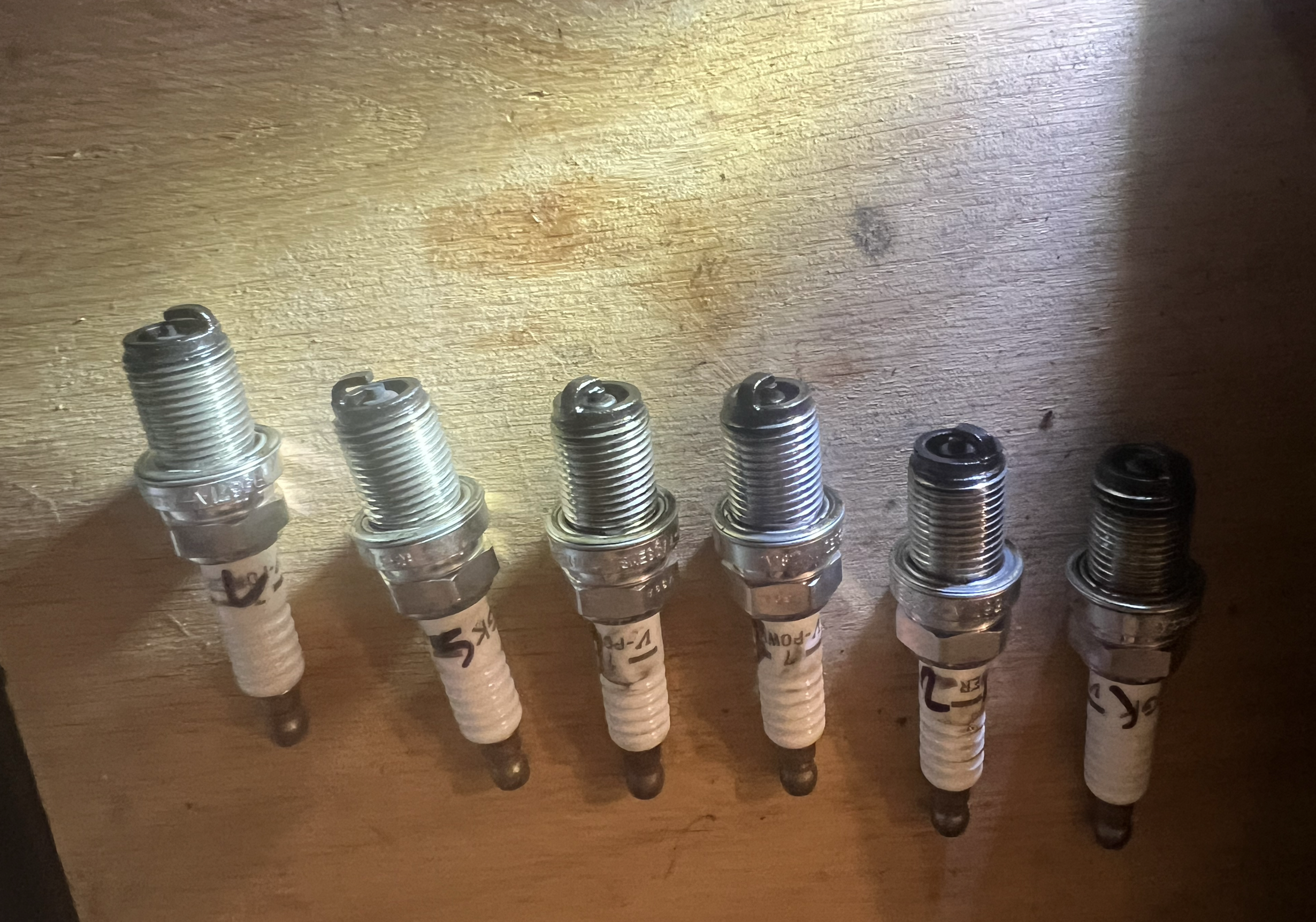

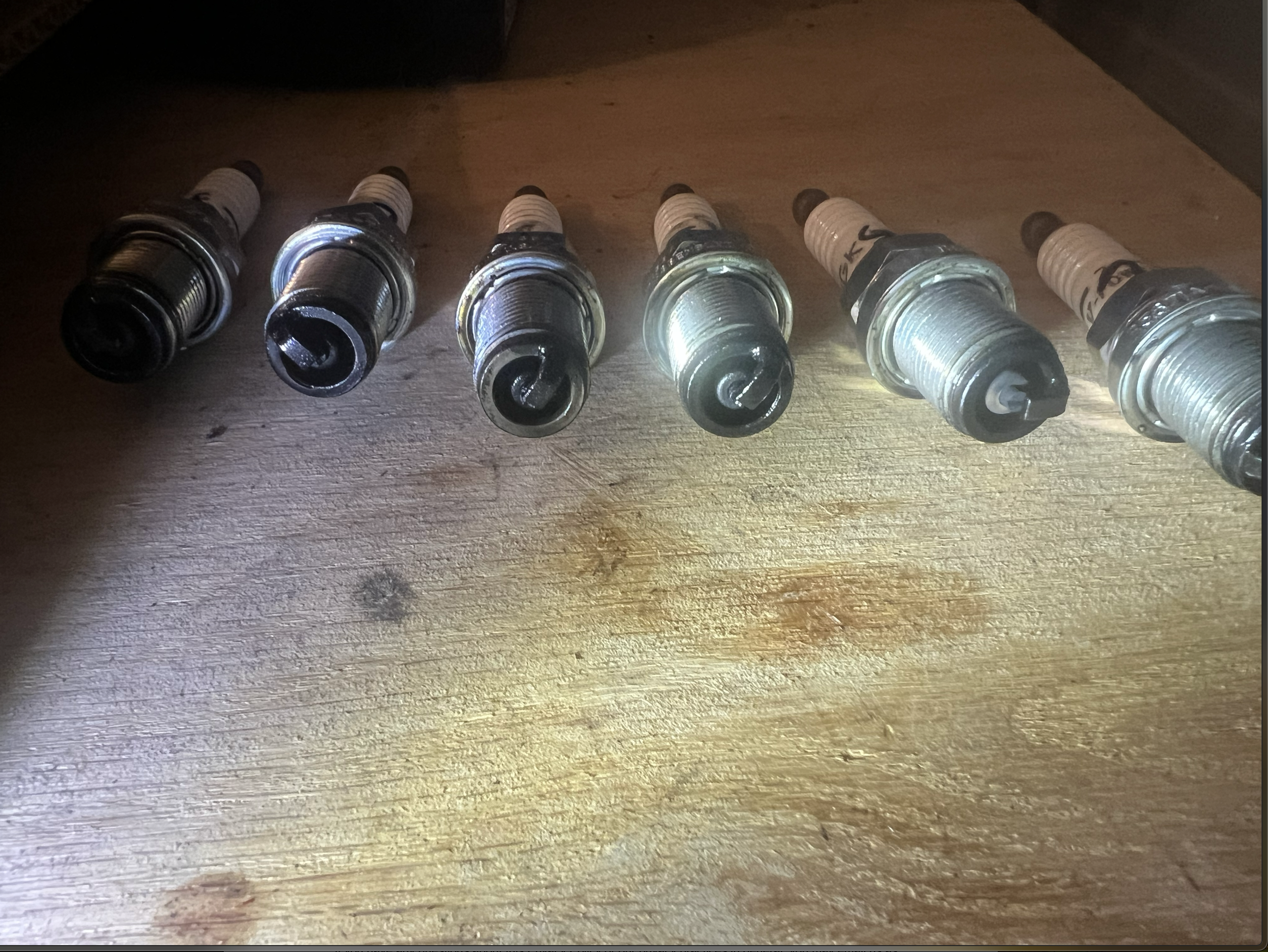

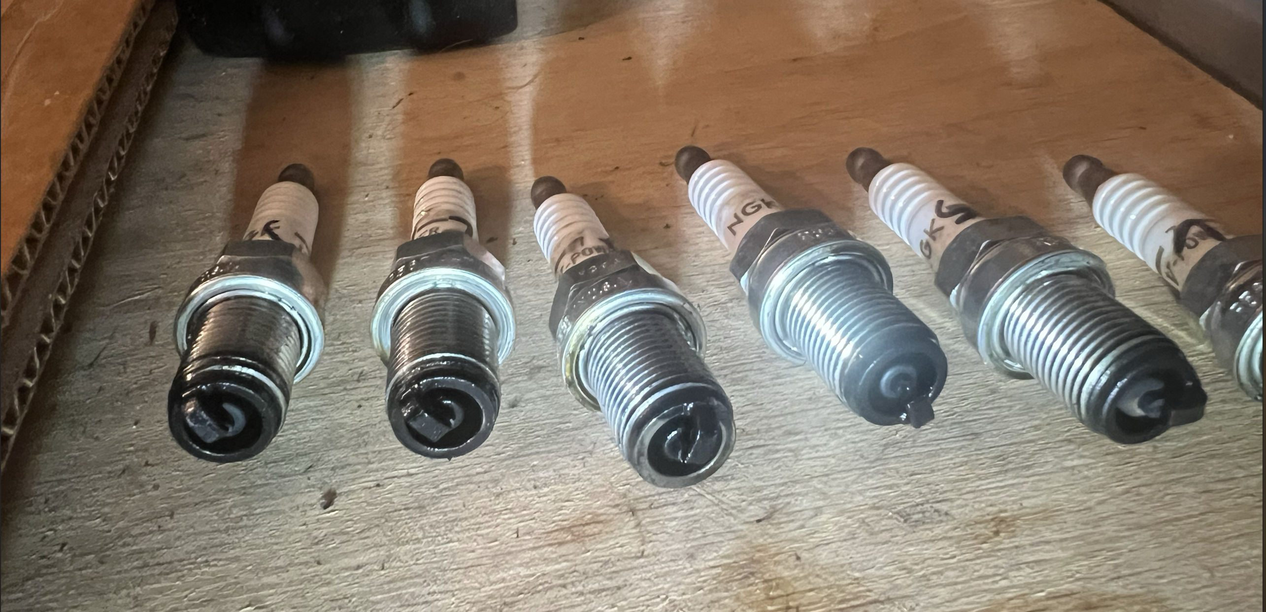

Another oddity, no blue smoke until temp is at 1/4.
Here are the plugs. (in for under 300 miles).
[IMG]
[IMG]
[IMG]
Only 1 of those running clean and dry. 2nd from the right You have problems.
