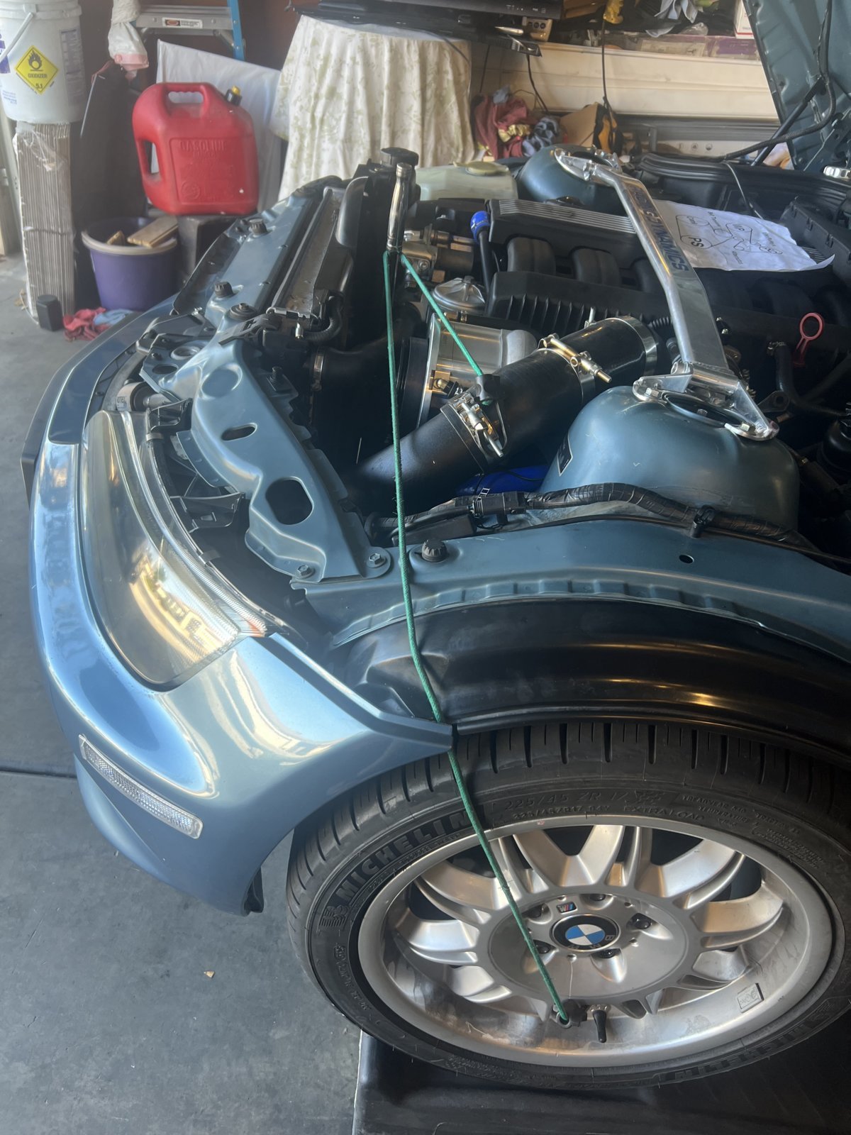

So, thanks to the difference in the S54 oil cooler housing & M52, the power steering pump mount is different & the alignment is off so the belts don't run properly.
I ordered an S54 power steering pump lol
The accident had nothing to do with the bungy, it was a pry bar to the radiator.

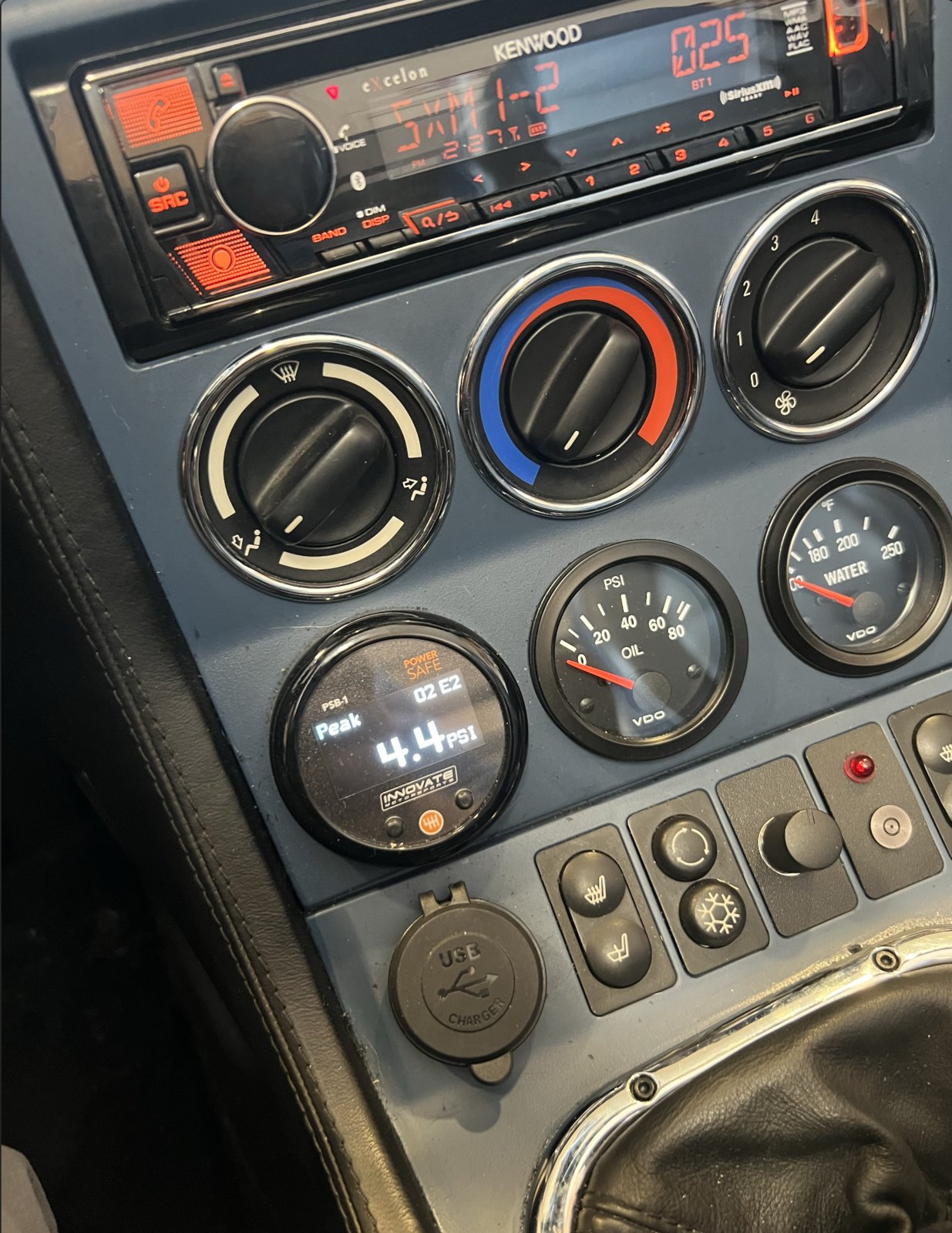

The sensor for the AFR/boost gauge is defective. Reads 22.4 when revved and 7.4 at idle.
Searched forums, found it's a known issue if the gauge does not like the ground.
Opened the pita to open center console ran the ground to a bolt holding the gas pedal assy on the car, no change. As I bought the PSB1 direct, called Innovate. After some drama, they are sending another O2 sensor.
I have one I bought for the Sequoia that disappeared, searched and searched, then it occurred to me I put the new one in the box the gauge came in.
Mystery solved!
