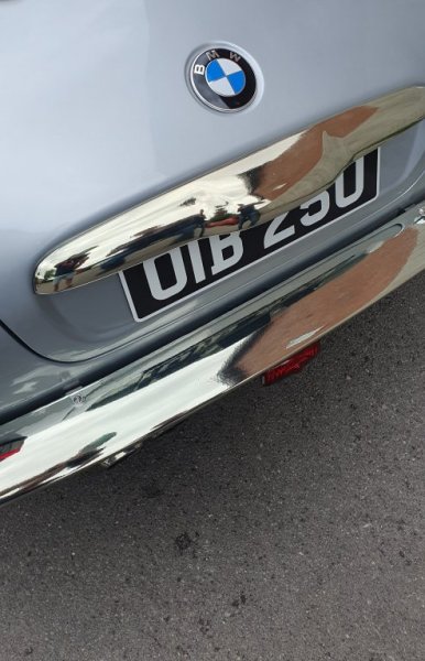

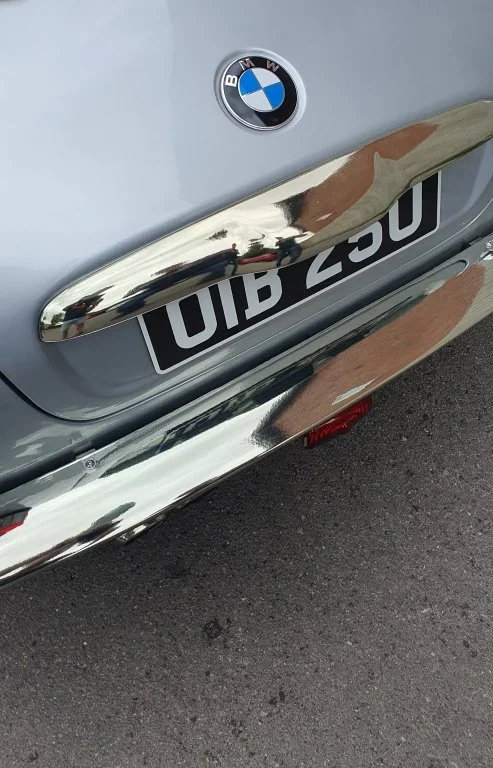

although it’s good to be relatively close View attachment 306629
Nice to see your bumpers are still looking relatively chrome like. Mine appear to be getting worse with every exposure to the sun. Mine now look rose gold in all weathers 😣
Still need to find a solution
10stb
Jun 7, 2019
53
The only job I outsourced 😖 I filled in the 500 on the boot handle and got him to do it at the same time as the bumpers. Maybe I should have left the boot handle as the fiat factory chrome effect.

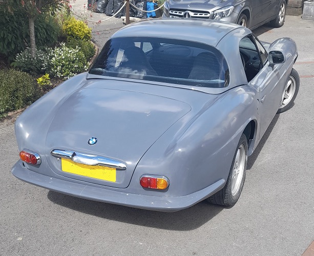

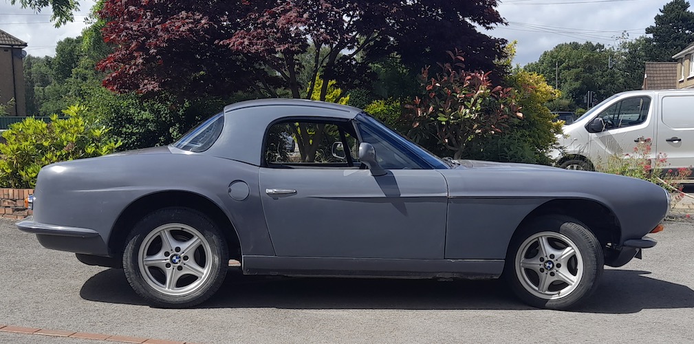

Done a rattle can job on the Hardtop to make it - almost - the same as the rest of the body/gelcoat.
The next time you take that excellent hard hard top off would it be worth placing a long piece of card along the new Lower edge and tracing the outline to form a template ? Or is the general feeling that the 507 panels don't fit consistently enough for others to use the same template?
159
Pontrhydyrun - in Crow Valley
I don't think anyone could, or should, use a template made from my car.
Each car is slightly different. Each one is installed different too. I think my rear panel is mounted a bit high in the front/middle. The left isn't the the same shape as the right.
Tribute did make me an extra sheet of grp moulded around the front of the rear deck but I couldn't use it as intended but it certainly helped, a lot, as a guide and as material to fill the gaps.The roof needs so much cutting off that it's no longer directly above the body and it's just a case adding and removing material by eye. The roof is also double skinned with a metal bracket for the rubber seal. All that has to be chopped off. If you have a hardtop you'll know what I mean.
For a lot of the work I had the roof suspended over the car as I was working.
Don't want to put you off. It's a lot of work but I think it's worth it.
